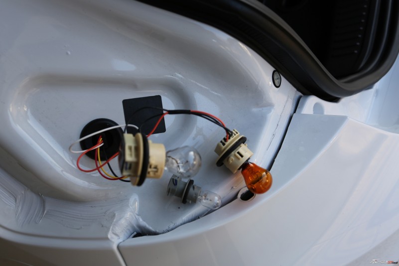

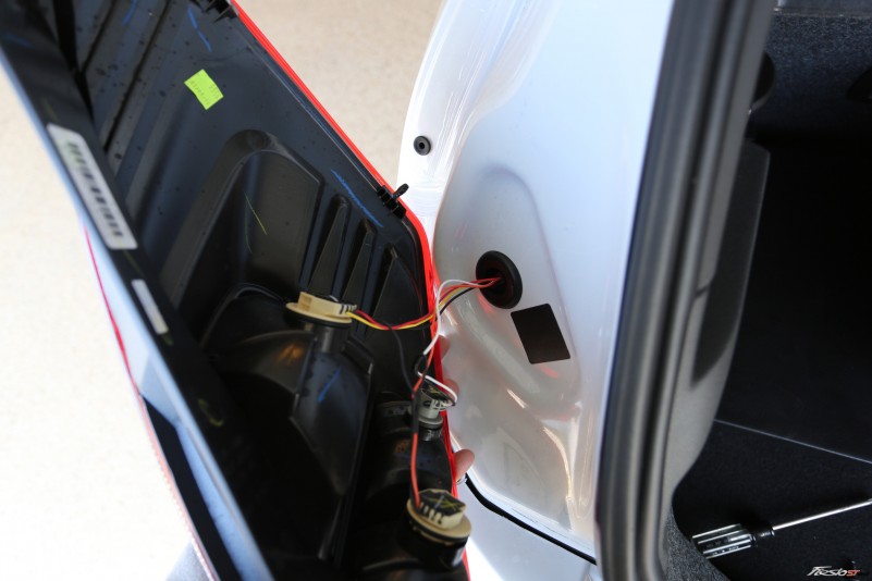

Step 3 - Gently pull the rear tail lamp housing from the mounting sockets.
Step 4 - Untwist the bulbs from the housing.
Step 5 - Bulbs.

are there only 2 mounting sockets? I unclipped 2 but still seems to be held by something.... Hmmm the manual says to take off all the carpet to get to them :/
