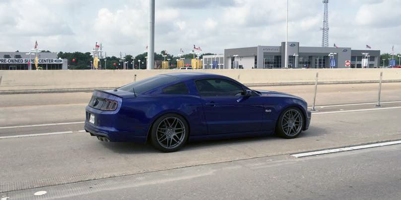

I'll start with a 15 st3 started buying parts planning only going to a stage 3 but have surpassed all expectations of the car and build as of now. This is my first car in 10 years have been building all different types of trucks from bagged rangers to lowered and lifted f150s. The last car I owned was a 94 talon tsi. So I'll start at the beginning of this build.

Current state of build thanks to Deadhook Motorsports, boomba racing, design engineering inc., pierce Motorsports, powerflex USA, Ortiz custom pods, tire stickers.
