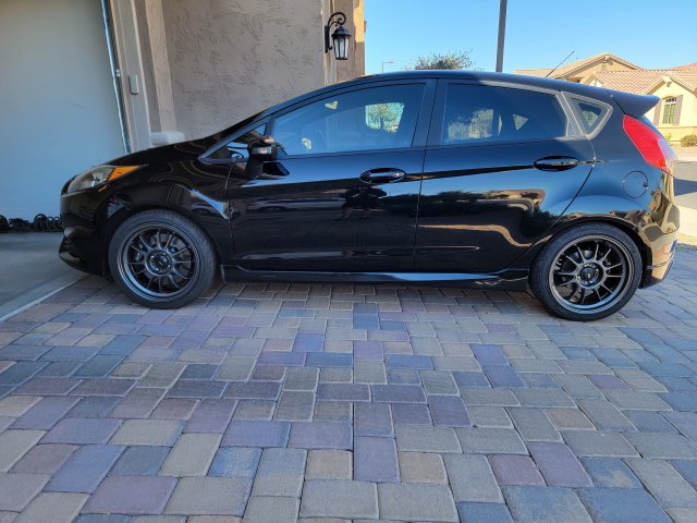

After wheels and front BBK

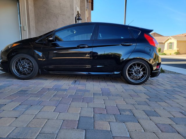

After rear WaveSpec rotors and ISC coilovers

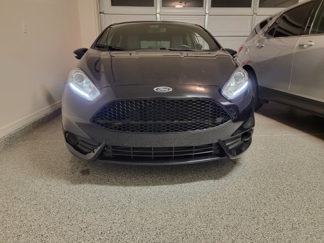

After Euro headlights

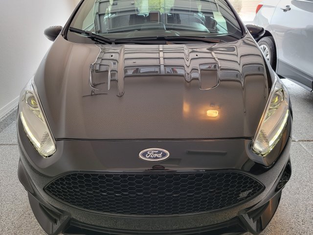

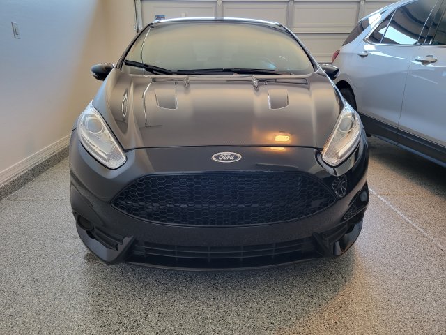

After Seibon TM-style carbon fiber hood
After PPF applied to the hood and headlights
