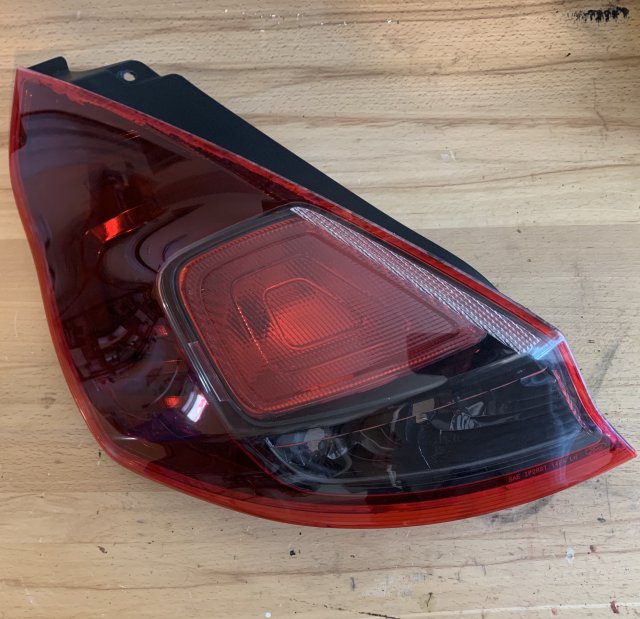

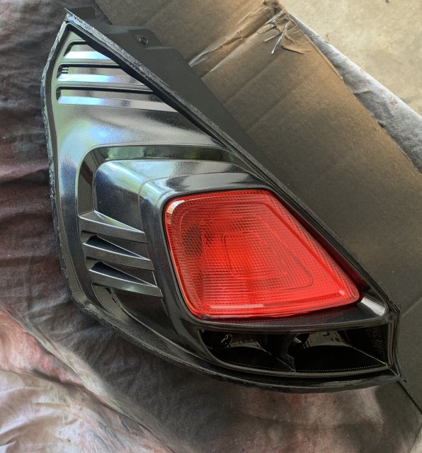

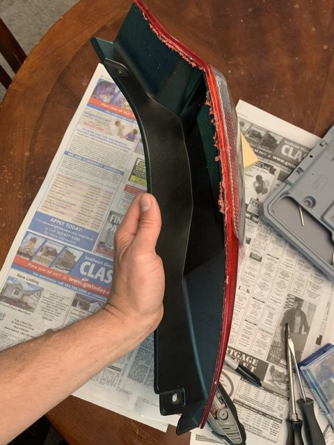

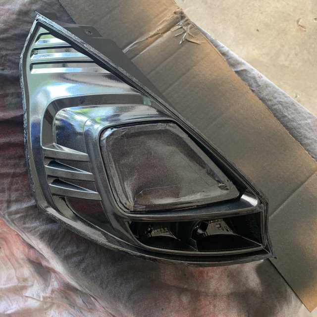

Pretty happy with it, just need to do the other side now. Didn’t want to do both at once because I had no idea how it would go or what it would look like. So now just need to see if they leak and then I can do the other side. Easy enough.

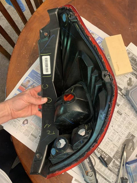

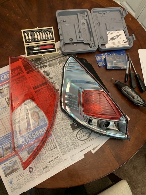

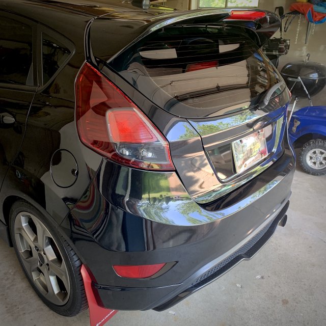

Got the other tail light painted and installed... they aren’t perfect. It was a learning curve... but, I like them for being free or whatever. Might keep them if the imperfections don’t bother me to death after a while. I definitely think they’re better, imperfections and all, over the annoying stock chrome.

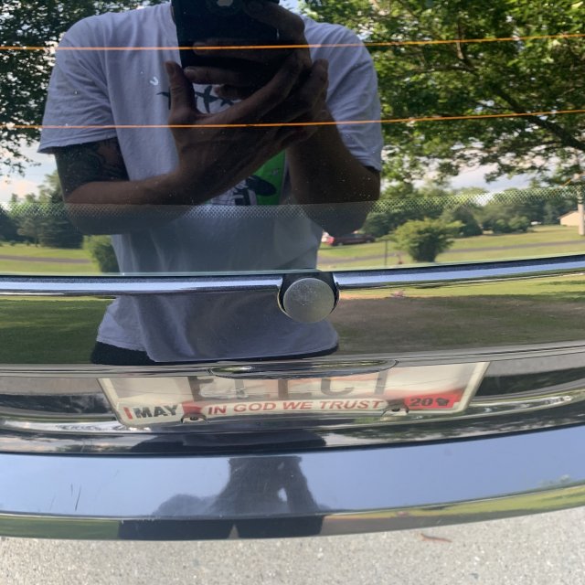

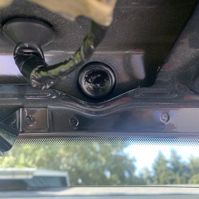

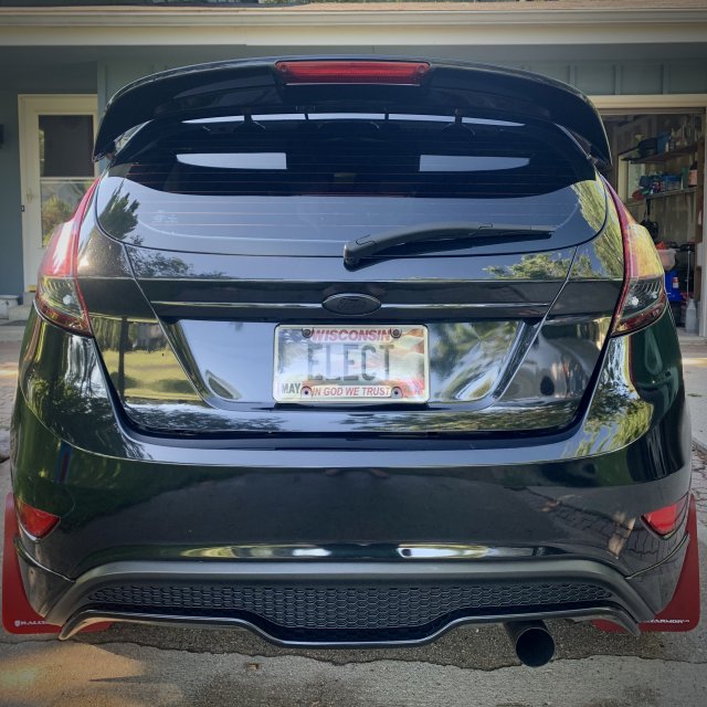

Wiper delete.... had some black silicone and a plastic body clip from the hood liner lying around. Just removed the wiper arm and motor. 8mm socket and 13mm socket. Pumped the factory grommet full of black silicone and slid the body clip onto the rubber existing plug. Is it as amazing? Not really, but it was certainly cheap as heck and I think looks fine. Looks less like a mini van back there now. Might switch it out for some rubber plugs later if it bothers me and/or leaks.

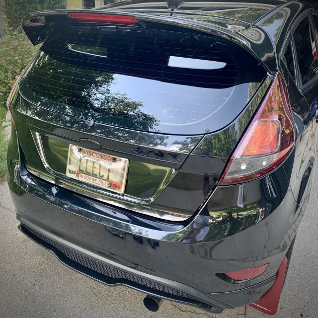

Some random IRL shots - can’t wait to get my turbo setup installed... feels like I’ve been sitting on it forever. Oh yeah, I have been. Been trying to do side work and stuff to catch up on funds for the last push of items needed and a tune. Patiently waiting and grinding when I can.
