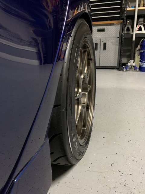

Federal RS series also a good alternative to 660s and also cheaper.
Im lowered and currently running 17x8.5 ET42 on 215/40 Federals and im barely threading the needle on fitment. A bit more camber will fix it completely. With stock height, you wont have problems fittting anything below those specs.
