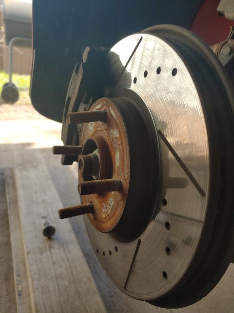

2 year old h&r wheel studs. πŸ™ƒ

20200511_164525.jpg looks like its time to order some ARP ones like i first should have. Also some steel closed end extended lugs.

I was fortunate to have enough ARP. Extended studs left from my zx3 for the drivers side wheel. Im going to order enough to finish the other 3. I need new front rotors after the deer strike and some closed end lugnuts. I may try the lithium grease on the arp studs as long as it doesnt jack with the torque values. Ive only had an oe one on my zx3 bust from age. Never had ones stuck so bad.

^ fortunately late model GM has the same pitch and pattern. Gonna go a smidge shorter as i really dont ever use spacers anymore either.

My guess is since that wheel didnt get pulled when the crash happened to fix anything it rusted tight and stayed stuck. It broke my breaker bar, and i had to really reef on it to get the lug loose. I even used pB blaster. Im gonna drop to a shorter stud all around and get some closed end lugs if i can. I might just pop my stock studs back in.

Are the ARP GM 12x1.5 stud press-in seating splines the same as on our hubs, or are those universal/standardized across the board for press-in studs??
Far as i can tell they are splined the same or very close to it. Never had an issue once going with arp on the zx3. The knurl length may be different for some cars.
