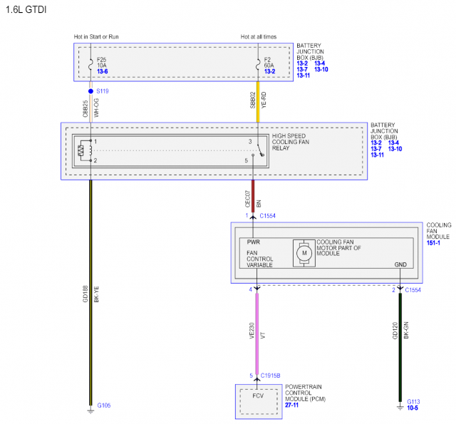

Are there separate relays for the low speed and high speed fans??
I am wondering why my car seems to be the only one out there which will run cooler (with the factory radiator) when the AC is on, than when it is off (in stop and go/crawling traffic and sitting at stop lights). [???:)]
When/once moving above 25 MPH, with the AC off, the temps will drop to the low 180s to a max of 188, even in the 98*F ambients around here lately, so this is perplexing.
Could the low speed fan just not be switching on at all, and the temps drop with the AC on because that instantly switches on the high speed fan? [dunno]
4,343
2,866
Some vehicles (if not many) operate the fan in sort of a fail-safe mode where it runs until the ECU shuts it off. Sometimes they always run following an engine start then shutoff. Might be the case here dunno; but instead of being shut off the ECU engaged it on a higher speed. Per diagram it's a single relay. There's a module attached to the fan. The module receives info from the ECU/PCM and the module in turn controls fan speed.
