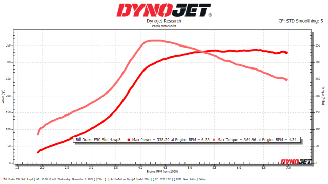

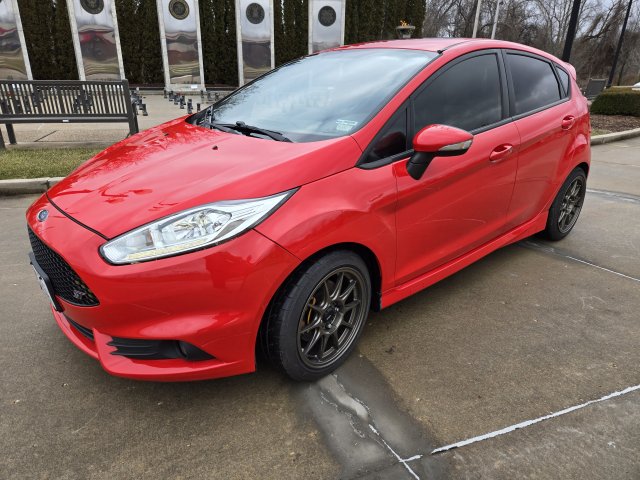

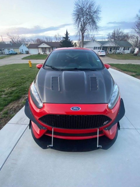

Joined this group a while ago (like several years ago!!), but haven't ever really looked at/used this forum. Planning on changing that. Some pics of the bean, as well as a dyno run from early November. I've done some of the work, Panda Motorworks has done some of the work. Mod list below.

With regards to the dyno plot, I am very happy with a consistent, reliable, not-gonna-break-anything 340 hp out of this car. I am certainly aware that some folks would push this harder - I am NOT "some folks." 29 psi and 340 hp to me is just fine, and that's where I'm leaving it.
Anyways, thought I'd (finally) introduce myself and the car.
I can honestly say this car is the most fun I've ever had driving. Solid, planted feel, a ton of power...driving it makes me very happy!

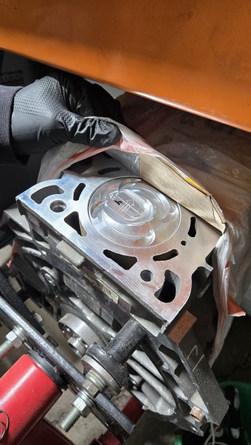

Did the Panda short block include any forged or balanced internals?
Still open deck or was that modded?

We looked at going with forged internals, but then COVID happened and the forged bits were hard to come by....we did try one forged option but kept having rod-crankshaft bearing failures, so reverted to stock as after all that I changed my goals for this build to just be stock-max. So, still open deck as well.

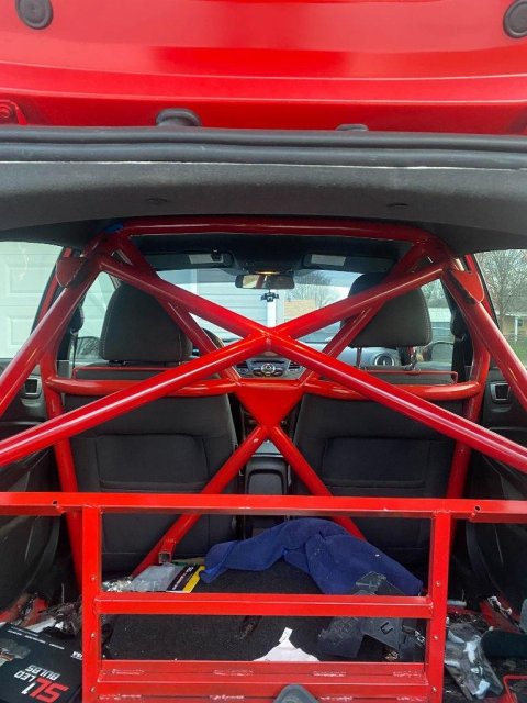

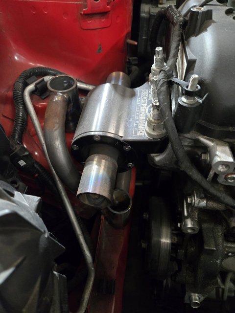

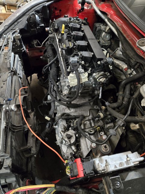

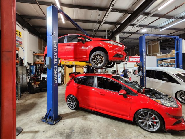

So, looking at what options were possible for a big HP Fiesta, we decided that it is feasible (and interesting) to look at putting the 2 L Ecoboost engine into a Fiesta. So I've gone that direction with a second Fiesta ST...lots of work has gone into the car, exclusively by the folks (Chris and Zach) at Panda Motorworks to date.
So, into THAT car...

Panda Motor Works Stage 1 2.0 Head × 1

1 x PandaBuilt Stage 1 Short Block (2.0)

Box Frame Rails To Create More Space
Fab Motor Mounts To Fit 2.0 Engine
Used Ford Focus ST Transmission
COMPETITION CLUTCH TWIN DISC MPC FOCUS ST/RS × 1 Yes
AEM CD-7G Carbon Flush Digital Dash Display w/ Internal 20Hz GPS & Antenna × 1
Cobb Ford Performance EcoBoost ECU AccessPORT V3 × 1
AEM 6 Channel CAN Sensor Module × 1
Re-wired with Focus harness.

Obviously this car is being put together with serious track days in mind.
Some pics attached. Definitely a work in progress - hope to get it wrapped up by summer :D
The air cups are for the front - so I don't bottom out getting into my driveway which has a bit of a lip .
Pic of the two cars is both of my cars - little bean over the big bean.
