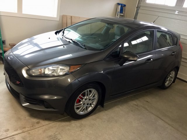

I’ve been running the same wheel size 15x6 Ford 6Jx15 wheels on my 2018 for 3 years, no problem. ET 52.5 though. Tire size 185/60/15. Great for a winter setup and smooth drive. Just enough room for stock caliper to clear also. 88167BD7-8103-4D70-B30D-5BC088298797.jpeg

That was my concern.
Saidly no, with a spacer the lugs nuts would not have much to grab on to.
Not much,, but enough,, imho. 5mm spacer will reduce the number of turn from approximately 9 or 10 to 6 or so. Sorry I forgot to write it down when I put my 5mm spacers on with the SVT wheels. That's enough for me. They are summer tires, so I've not had a chance to give the fewer turns on the SVT's the full test.
I've stated how I ran my Volvo wagon with 4-5 turns on KMC wheels. Aggressive driving and never a problem. Potholes were.
