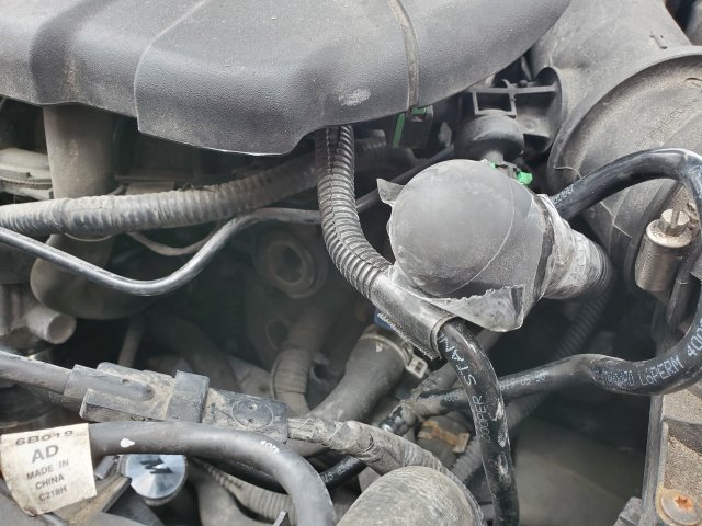

So the shop had put the cap on the end of the symposer that was connected to the intercooler piping. I removed the symposer, and taped the cap onto the end of the pipe that leads to the cabin (I did an ugly job, will tidy later). Can you let me know if this is sufficient? There is now a hole where the symposer leads towards the engine (see photo).
265
273
Cape Town, South Africa
This looks good to me, a little janky but it'll work. I just janked that pipe hard and it came out. put a little cloth in the hole where it was connected to the cabin. Looks fine tho
