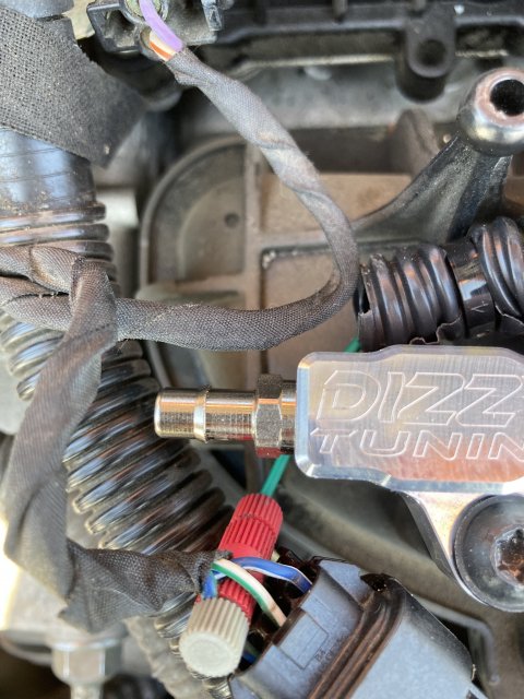

my fiesta is turning off while driving with the battery icon lit and the oil light lit . I’m afraid this car will turn off while I’m driving on a highway or intersection . No engine codes pop up thank you .

Usually with a battery/charging problem, once the battery is depleted the car will not start.
However, since it starts, lack of oil pressure will shut off the fuel pump.
I would start by looking at fuel and oil systems.
Both of those systems could have been affected by your big turbo install.

I would start driving and it would shut off and I would have to turn it back on and it would keep on doing that until I just the car off

Definitely sounds like a fuel issue to me.
