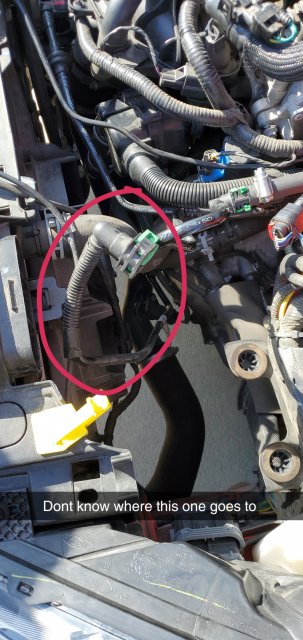

Today I just installed the 2J Racing Cowl induction intake on my 2016 FiST and in the box it came with 2 hoses but there are 3 in total that are connected to the factory airbox. I stood there scratching my head for a while trying to figure out where to attach the other hose, I'll leave a picture with the hose and maybe someone could help me on what to do, because i took it for a test run trying to figure out what codes it would throw so i could better understand what the hose was for. It popped up two codes; P1450 and P2282. Anything helps Thank you in advance

I know the 2016(?) and later intakes are different- Whoosh sells a kit to adapt them, although I'm not sure it would work with the 2J, given the unique location.
You are a lifesaver! Thats exactly what i needed. They do have the adapter for the 2j now and its only $10 more. I appreciate it a lot!
