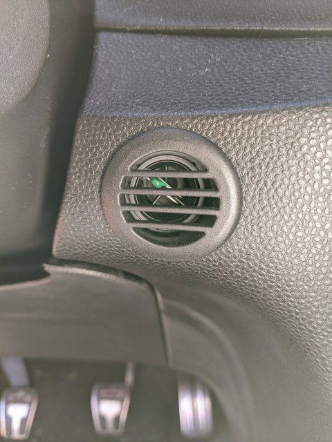

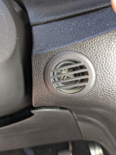

I've started to notice a similar issue. Outside air was 68 and I set it at 65 (no AC) to just have the fan on as it was raining. The air coming out of the vents was hot and would only start cooling down if I set it below 61. I was also thinking that it'd be a cabin temp sensor. My guess would be the plug near the cabin air filter?
147
28
Summerville
I did a little bit of googling and came across this. https://www.youtube.com/watch?v=KsunF1LLFy8 Seems to make sense, so I took a look and its a little harder to get to than in the focus, as you'd have to remove the leg airbag or center console. So, I used a shop vac and a paint brush to clean mine up. Seems to be working correctly for now, but will monitor it some time. If the issues continue, I'll probably look at troubleshooting it.
