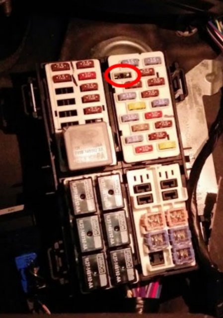

Are there any other fuses I can tap into besides the one below? It's already taken for my ethanol gauge. I need more for a baby camera and radar detector. I'd rather not have to piggyback twice into the wire for my ethanol gauge if I can avoid it.

The one to the right of it is for auto-dimming rearview mirror and rain sensor which our cars do not have. It should work fine. 7.5 amps should be plenty for a camera and radar detector
