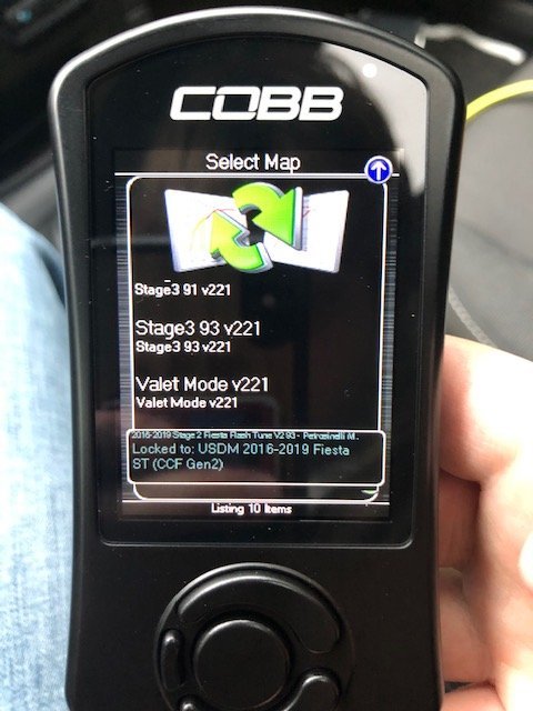

Hey guys, just got my FIST to Stage 2. Trying to replace my Cobb OTS tune with a Dizzy tune I recently purchased. When I try to change my map to the Dizzy tune on the AP, it says the tune is locked (attached the error message). Does anyone know what causes this error/how to fix it. Anxious to get this tune working! Thanks!

Did you try to uninstall the AP from your car before trying to installing the new tune?

If you bought the AP new, maybe you should contact COBB.
If you bought from a Private party it should have uninstalled from the previous owner's car.

1. The tuner should provide support for assistance in using their tunes.
2. Contact COBB on instructions to update your AP and OTS files also, as judging by the current Gen 1 files it’s outdated.
11,513
8,007
Have you updated your accessport lately to the latest Version?
