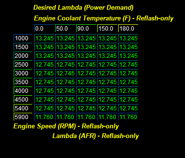

Factory tune targets 12.7 AFR until higher RPM (5900~) where the turbo shaft speed is very high and the increased fueling is to provide cooling to the pistons from the hotter air entering the cylinders.
The fiesta st is an open deck motor and because of the improved cooling, it can run much leaner.
Below are factory values.
