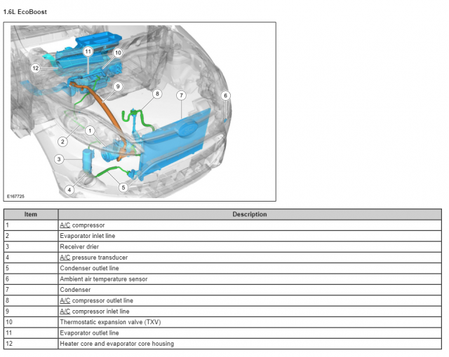

Had my engine replace by regular machanic my ac compressor is not gettin 12v
I test all fuses and relays under hood and dashboard test good
Anybody knows where the low pressure and high pressure switch location or have ac diagram to the fiesta?

I will try to find the shop manual link somewhere. If I find it ill PM it to you.

Problem solve when mechanic replace engine he broke the ambient temperature sensor
Ecu stop sending signal to compressor cause of that
Bought $10 sensor plug it in
Cold a/c again
