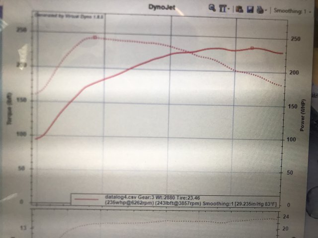

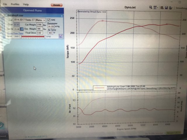

So I have a hybrid turbo installed in and tuned for 93 octane . My Cobb access port is showing 266 hp and 260 tq which sounds right. But I’ve done about 5 v dyno runs and it’s only showing 235-245 hp? I data logged using all the parameters that the tuners request. I selected the fiesta st in the drop down menu and the gear. Am I only making 230hp?? I’m at sea level.

What wheels and tires are you running? For mine my diameter was .44 higher than default and my vehicle weight is about 20lbs heavier. Also check what you have on smoothing 2 and 3. I think I used 2.

If you put garbage info in you’ll get garbage info out. You can make it read 400whp if you want to.
I used vdyno on another platform with the mustang dyno profile and 1.01 correction factor. My papers read 330whp and 380wtq but I was gapping (like not even close) 2nd gen coyotes from a roll.
What’s more useful is seeing your gains from baseline.

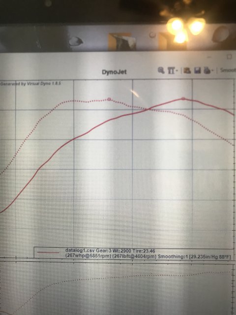

Thread Starter #13
I was able to get alittle better numbers. I guess the accessport reads crank hp and the vdyno is supposed to be wheel. So the accessport should read higher. I’ve learned smooth roads is important and need to make sure you have your right tire size and car weight with you in it. My final tune on e30 showed 267 whp and 267 tq. Which sounds about right with my accessport showing 285 hp (crank). When the weather gets cooler I’ll see if I can hit 270hp.
