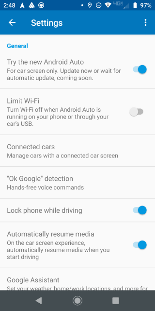

I have a Moto Z3 mine disconnects too but I think it's my USB cord. Android auto just came out with an update, go to the app and under settings flip the toggle for, "you want the new Android auto." Screenshot_20190810-144838.png
Thanks for this!
Man that new android auto display kicks ass, I love it.
