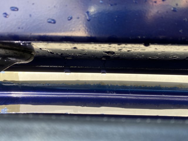

Anybody have this paint issue? Just discovered it and how Do i get ford to fix it?

Has anybody pulled their interior panels to inspect for defects? I’m going to Ford on the 16th for them to take pictures, they want me to point them to any issues.
Seems like all flaws are at the bottom of panels where water collects. At least in my case.

Upon closer inspection, the corrosion is more wide spread in my case. I originally thought the issue was only towards the bottom of the effected panels.
I’ll keep this thread updated, but Ford was receptive on the phone to repairing this. I should know more next week.
For science, I attached some pictures.

As an update - Ford denied honoring the warranty. They said because the corrosion wasn’t through both sides of the panel, it didn’t qualify.
It seems like I’m about to get a lesson in how to apply rust encapsulator.
OP, hopefully you have better luck than me.
The exact thing they told me....i was like OK. Left them a scathing review on Google. Service manager/ owner called me and asked me if we could talk about it and remove it. I was like NOPE....you denied me and this is a reminder how you guys treat people and the quality of product you peddle to unknowing people and then screw them in the end.
