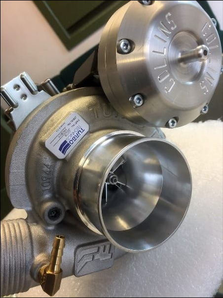

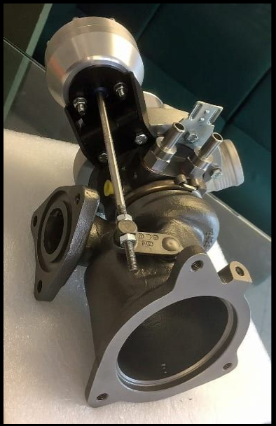

This might be a moot point as I can't find a supplier in the States and every British TT S270 won't ship stateside. My last hope is Collins Performance (which would be my first choice anyway but waiting on their CustomerSupport to respond back with a yes/no) but they use a proprietary WGA Collins Performance 1.6 Ecoboost Actuator - Collins Performance .
Edit: Well Collins got back fast. They quoted me a 180GBP shipping so factor in return shipping this is probably about $1500 once everything is said and done soooo about the same price as a whoosh hybrid. But based on everything provided this seems more like Collins' version of the Peron S284 kit. of a full bolt on turbo kit using their own WGA. From what I can tell by the pictures the only things I'll really need after this is a upgraded FMIC, tuner and the uprated injectors.

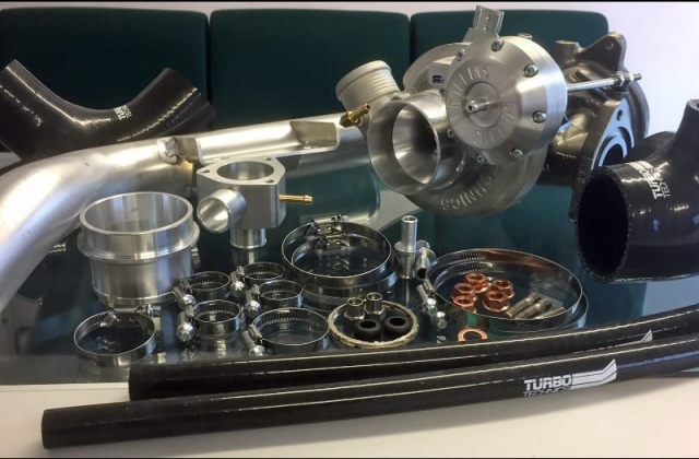

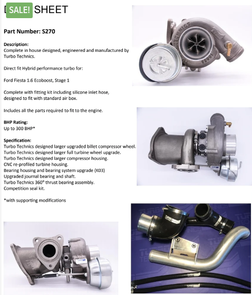

Here is the only British seller whose site provided the info on what's in an S270 TurboTechnics S270 Hybrid turbo kit for ST180 - H-Sport Performance (hsportperformance.co.uk)

the Peron S284 is in fact the S280 base turbo
Peron adds an uprated WGA and BPV to the kit which makes the TT S280 their own Peron S284
The S280 and S284 are completely different than the S270 which is has a modified stock KP39 turbine & CHRA with TT proprietary comp housing
The S280 / S284 do not use any KP39 components
In your quest for cheapest turbo possible you may have left out that we also take in your core so the whoosh hybrid is technically $1349 shipped to your door for comparisons sake
