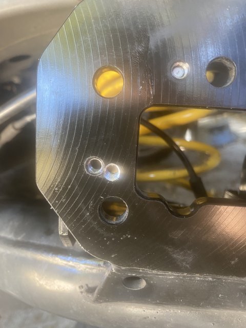

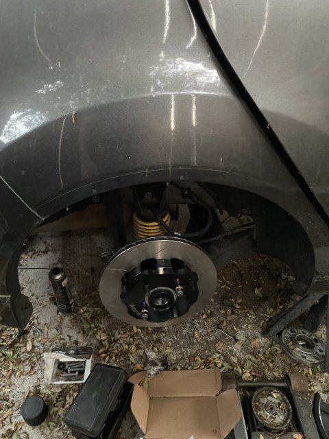

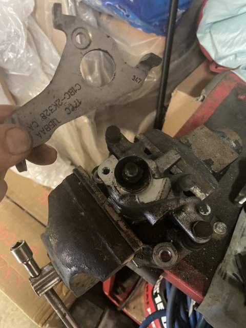

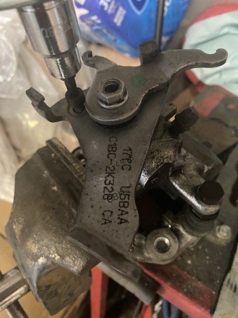

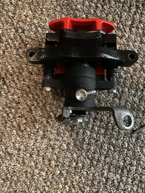

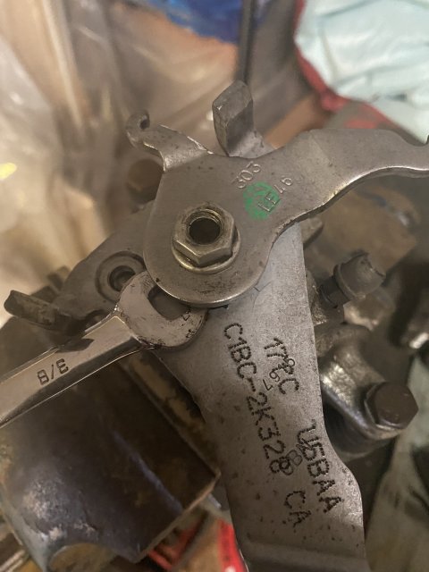

Just came across this. The brakes fit perfect to our rear beam but they require the standard fiesta Timken stuff etc. You don’t need the alignment pins but I removed mine then reset and drilled and taped the holes to perfect alignment on the new timken stuff. This way I can use either setup… worked great…

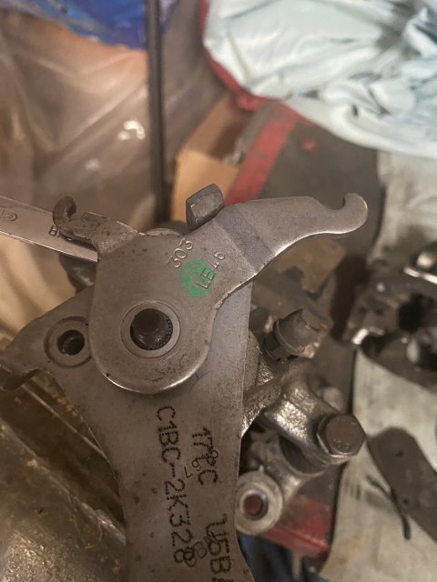

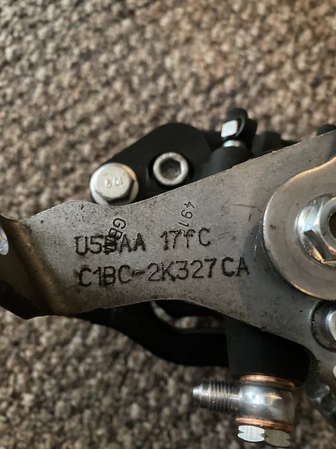

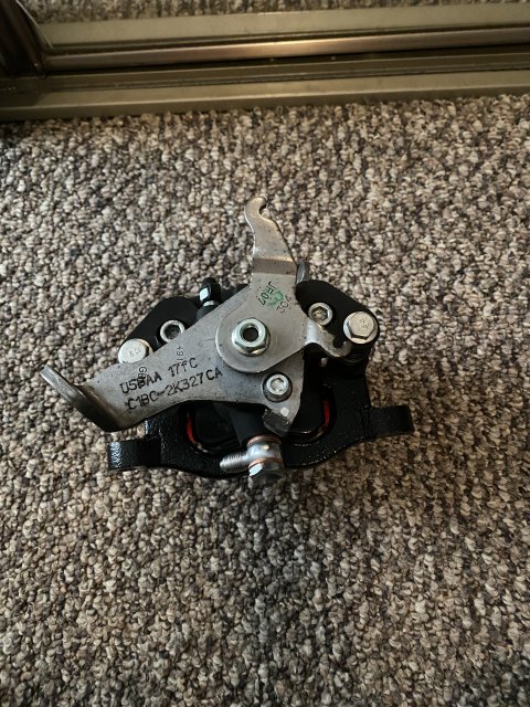

The recommendation from me is do not use the brake cable extensions offered. You can Mount the oem cables and only need to take the rear oem cable brackets and arms off the oem rear calipers.
it was an easy swap. Be sure to bleed everything very well. Now you have 2 pistons in the rear on each side so less fade risk… aluminum hats etc all much much lighter… My car stops like no other I use 20 mm space red with stock Tires and rims and zero brake fade. Check my videos on IG @turboslurpee
