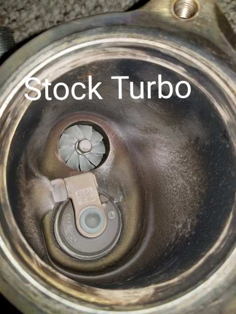

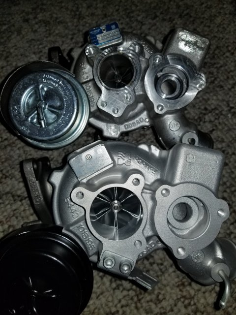

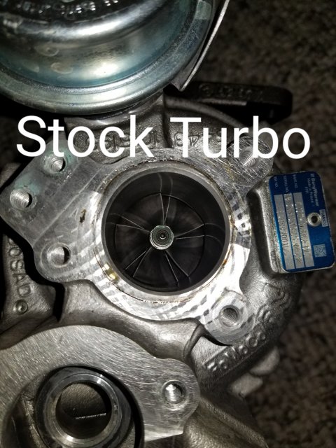

I bought a used X37 over the interweb that arrived today. I set it down beside my OEM turbo and they look identical. Both turbo's compressor wheels look identical to those found on the X37 yet both exhaust wheels appear to be stock.

The X-37 is supposed to have a 54mm compressor wheel and clipped turbine blades. Those two turbos look identical to me.

In the side-by-side pick up the exhaust wheels, is the purported X-37 on top, or on bottom?
#9101
37
16
In the side by side that says x37 and stock, the stock looks like a focus st stock turbo not a fiesta you can also see the x37 has clipped blades and the stock does not.
