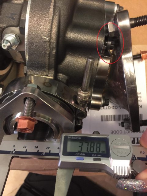

For the third time in the 12K miles I have been running this turbo, two of the five 12-point bolts that hold the downpipe adapter (ugly piece welded up by ATP) to the turbine exit and allows one to bolt up a fiesta downpipe with the OEM-style flange. The result of these bolts getting loose is an exhaust leak that, if not detected immediately, results in exhaust entering the cabin of the vehicle if HVAC is on in the car.
I have spoken to a number of fiesta and focus owners (mostly via FB) that have installed ATP turbo kits on this car and a number of them have also had this problem. I also know the Mountune turbo kit folks have had a similar issue and that brings me to my specificproblem.
The three bolts that do not get loose on the turbo also happen to be the ones that are not accessible with a 12-point wrench (one of which is circled in the attached photo). In order to remove the downpipe adapter and install an alternative adapter with the Stage 8 locking hardware (https://www.amazon.com/gp/product/B00776GZDQ/ref=ppx_yo_dt_b_asin_title_o00_s00?ie=UTF8&psc=1 ) and 8MMx1.25 studs, these bolts needs to come out. All the while I am hoping to do all of this with the turbo on the car. Short of cutting off the head of these Grade 12.9 bolts (which I am sure will take hours) what can I do to remove these bolts?
Has anybody had a similar problem and if so, what did you do? I have already tried using red loctite on the replacement bolts but the turbine gets way too hot for this to do anything. The bolts still loosen, fall out, and an exhaust leak occurs. All solutions I can think of (Stage 8 hardware or safety wire) require removing all 5 points and unfortunately, 3 of them are inaccessible. I have an email out to ATP asking what tool they use to install these bolts and also if they plan to address this problem at any time.

I don't run the kit but I know mountune now sells a set of expensive locking fasteners for the mrx but they should work similarly for the atp kit because the mrx is just a modified atp kit.

Correct, the stage 8 kit that I linked in my original post includes the same components from the Mountune locking hardware kit. The problem is still how to get the original bolts out. And who else is having the problem.

I'm afraid to say....Time to remove the Turbo. I have the Gen2 also. I haven't encountered this problem as of yet...its Been 10k. I'll check them all again the next time I'm under there like I always do. I'll use my Boroscope to really get at some of those odd positioned bolts.

Mine is MRX, one of the studs from the bottom actually fell out completely after it got loose. I went ahead and replaced 2 of the bottom ones with Exhaust bolts I had lying around and haven't had any further issues. Also Re-tightened everything, every oil change I check the tightness, so far it's held.

Yeah, I am considering the fact that if I remove the turbo, it's not going back on again and I will move on to the TT s280. ATP has been useless and it is just really frustrating that they design an adapter that has bolts that cannot be accessed at all.

Only problem I have had with self loosening hardware was the manifold to turbo v-band adapter. This specific problem you're having I haven't experienced
Had that one as well. went with a 1.5" bolt and a locking nut on top of the 2 back holes. make it like the front one that already has the locking nut.
