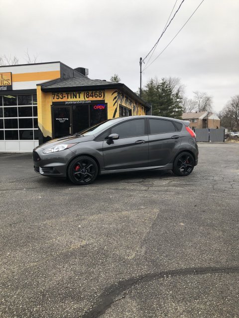

Went with MY KART for the plates. Installed Whoosh V1 intercooler today. Had to do a little trimming on a couple plastic pieces to fit. Was amazed how little and light the factory piece was. Also installed my headlight corner tints.
