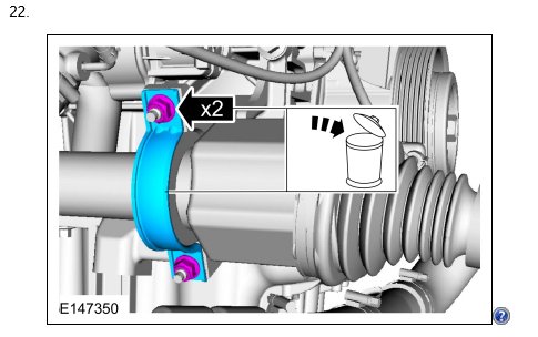

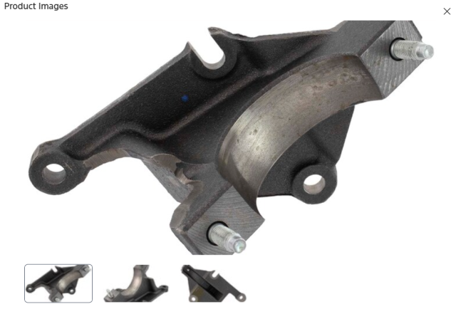

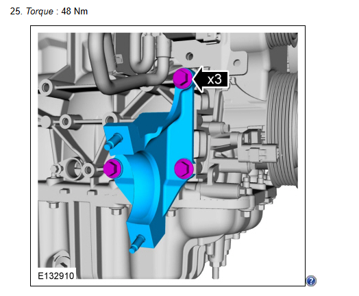

So, I am in the process of gathering parts for a gearbox swap as mine is severely damaged. I have a new to me box on the way from Both Tips Performance. In the intermin, I am attempting to identify the axle bracket nut part # as the service manual states that they must be tossed after being removed.
Does anyone happen to know the part #? Also, are there any other parts that would be a good idea to swap other than the obvious clutch, slave cylinder, and possibly the flywheel?

W520102-S442 is the part# for the bracket nuts.
Flywheel bolts would also be technically one time use. Those are AV6Z-6379-A and you need 6 of those.
