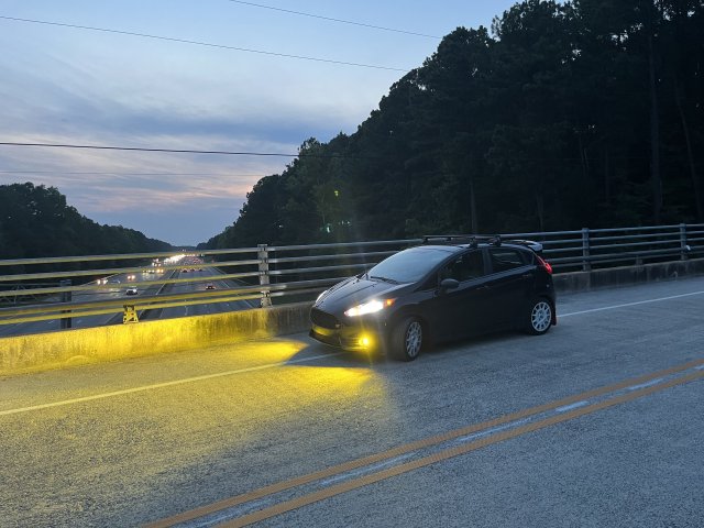

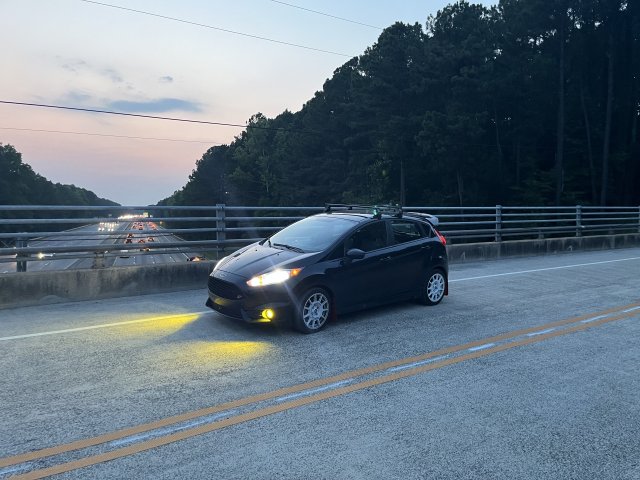

I now have these lights, I installed them last night so this is my initial impression. Installation was fairly easy and straightforward. You do need to splice the rally innovations connectors onto the wires running from the lights. Make sure you get the wires right, black to black and white to red. I also used the metal bolts rally innovations provided to attach the fog lights to the bumper cover. I like the ability to use the oem switch to control the fog lights. I have the amber wide cornering lenses and they have a really nice spread of light. I made some videos that will hopefully show y’all what I mean.

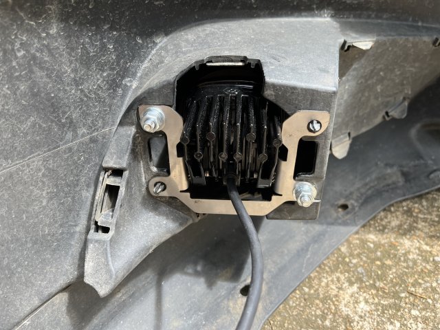

9D2E790C-F143-447A-B6BE-B5F31B2E4739.jpeg The rally innovations kit comes with nice metal brackets and hardware that are stronger than oem.
Unfortunately I forgot to get pictures of splicing the connectors but that’s pretty easy if you have wire strippers and electrical tape. I soldered my splices but twisting the wires together would work fine too. I would recommend that you make sure to wrap the splice with tape well since that area can get wet and dirty fairly easily.
