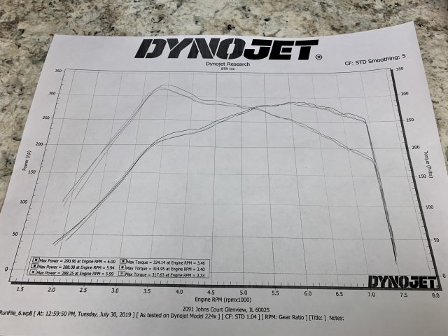

2019 fiesta at whoosh hyrbid turbo, car has 9000 miles and turbo has 1300 ish, the car at idle when hot will blow blue smoke at idle like at a stop light, it’s doing it about once a week and today it did it twice in a row. It’s really stated to freak me out because it’s either the turbo or the pcv system “i have a catch can” but besides that i don’t have a clue it did throw a P219a code, back when i picked the car up after install “BTR did it” and yesterday after it got dynoed and made 290whp. Car is running great but I’d love to figure this out
