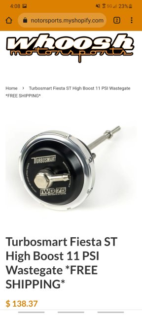

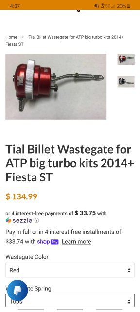

Hello all,
So i just purchased a gt2560r turbo. I am running into one problem, before I put it in should i buy an aftermarket wastegate?? Whats it mean be 11psi or the othe wastegate option between choosing the 15psi vs the 18psi?
I know the very basic of how a turbo works but the wastegate gets a little confusing.
Thanks

My understanding is that the spring determines the lowest boost you can run. You cannot run more than double the spring pressure. So a 11psi wastegate spring means lowest boost is 11psi of boost and highest is 22psi of boost.
Too high with the springs (and boost) and it's hard to get traction in lower gears in our cars especially. Too low and it limits how much boost, which is fine for the oem turbo (not sure it goes above 22lbs of boost) but not great for for say a Whoosh Hybrid (guessing around 28 lbs is what ppl run). For a smaller gt2560r, my guess is that the 15 wastegate spring is best as it would run 15lbs of boost minimal and 30lbs max. 18psi wategate spring would probably work ok but not sure if it's good for lower gear traction and fuel economy.

If it’s an ATP kit, it probably came with a 14 psi actuator which is fine if you’re staying on the stock fuel system. May want to upgrade if you go aux fuel. But as jabbit said, buy a tune and tell your tuner what your goals are. They’ll help. Jason @ dizzy helped me a lot with this initially.
