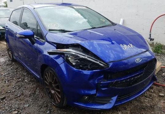

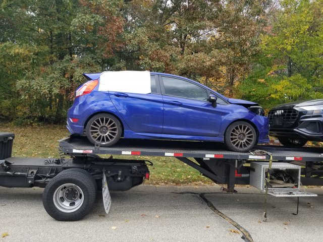

Enter the 2014 blue Fiesta ST purchased sight (sort of) unseen from Co-part. It was listed as running/driving, however the hood was stuck closed. Odd. Here is a picture of how it sat at the auction yard:

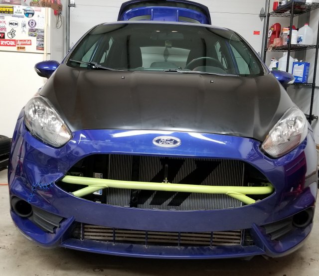

And here is how it sits now:

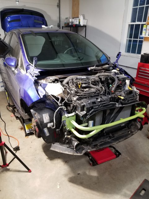

What's been done:
  • Remove and sell Recaro interior.
  • Remove and replace windshield
  • Remove and repair (sorta) crunched front bumper.
  • Remove/replace pass. side headlight
  • Remove/replace drivers steering wheel airbag, drivers footwell airbag, two front impact crash sensors, clock spring, drivers seatbelt (rebuilt original), airbag module (rebuilt original).
  • Remove/replace hood, radiator support and support bracket, torn coolant hose (one), torn evap line
  • Removed A/C compressor/condensor/drier and easily accessible lines; replaced with A/C delete pulley and belt; replaced broken guide pulley. Saved 20+ lbs and A/C was broken anyways.
  • Removed damaged radiator and fan shroud; replaced with Mishimoto radiator and shroud, using stock fan
  • Removed stock crash bar; replaced with TB Performance crash bar
About to be done:
  • Repair rear door hinge, change oil, add coolant, cross fingers and press Start button.

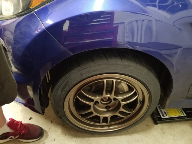

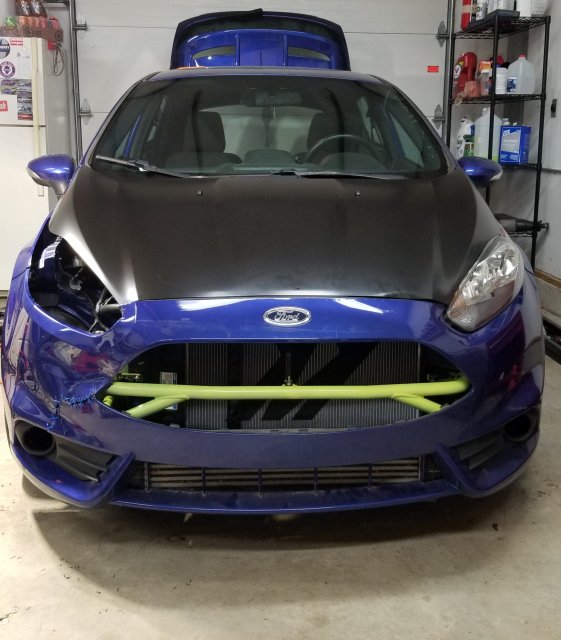

Rough mounted the hood, headlights, and front bumper. Mounted the rpf1s and I love how they look.

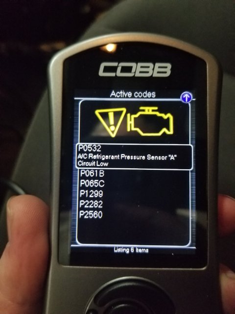

Pulled CEL codes tonight via accessport. Not worried about any of them really. Would like to figure out how to disable/bypass the A/C related one.

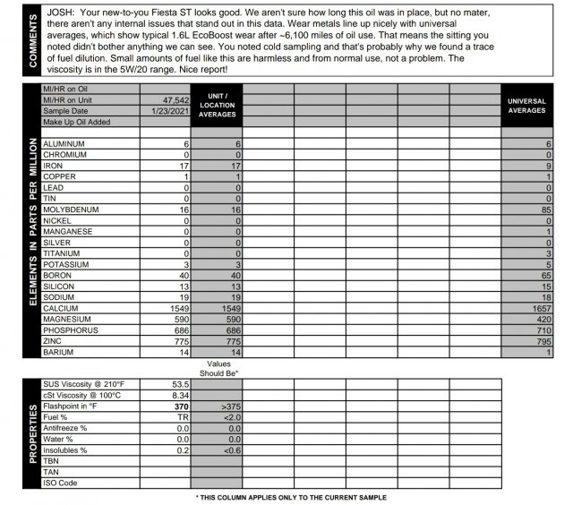

Drove the car for ~6-8 mins today, a couple miles around my neighborhood. Coolant dropped again but I suspect this is normal. I used the Motorcraft Yellow coolant and now there is a bit of the old/original Red (Orange?) coolant in the overflow mixing with the Yellow. It only dropped a bit below Min. so I think I'm ok. Expecting a Blackstone report from the oil any day now. Fingers crossed but I also expect an above-average water presence because I didn't want to warm the car up and/or bring it up to temp on the oil that was in there.

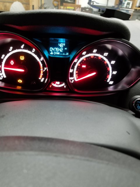

Reset the check engine light and reset the ECU via Accessport. I was thinking that since I didn't turn the A/C system on, then perhaps that's why the A/C code didn't come back. For the ~2 miles, no check engine lights came on. Just the "door open" light on from the hood sensor (I think) and the TPMS light on (no sensors in my wheels). Making good progress!

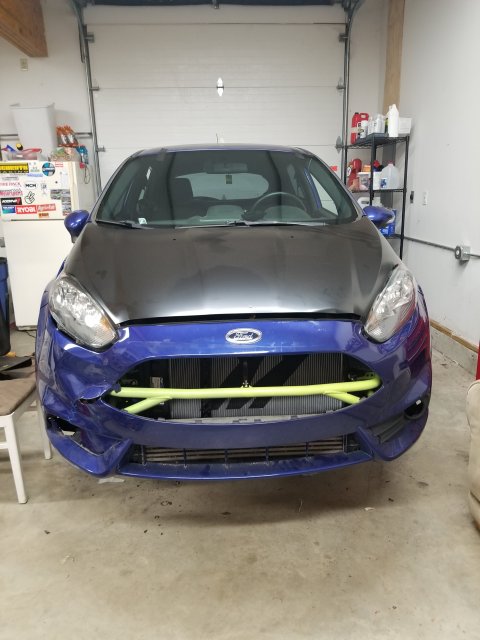

Update - removed the window tint and cleaned up the interior. I have to reinstall the horn, permanently mount the headlights, then do some more repairs on the front bumper. Anticipating my state salvage inspection completed by the end of this month or NLT first week of March. Not many updates until then. After it's inspected, that's when the fun starts....

Was super sick for about 3 weeks but back at it again. Everything mounted except passenger headlight and horn. Can't get the horn to work. Both ends of the connector are badly corroded which seems odd to me. Sanded down the pins on the horn side but the harness side looks bad too. Going to try to clean it with electrical connector cleaner but don't have it on hand. If that doesn't work I'll probably cut the connector off and solder on plugs or something. I replaced the clock spring so that shouldn't be it. I can hear a relay or something clicking when I press on the wheel. If I can get the horn working that's the last step. Then schedule salvage inspection, get temp reg and do some shakedown miles on the street with my fingers crossed leading up to inspection. She's rough on the outside but I'm already in love.

Thread Starter #18
