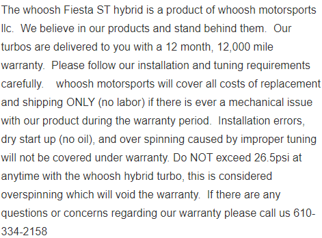

Sorry, anything over 26 or so is above a hybrids rated max, that is not normal... When people say how much boost they make they always use that peak number, which is not even as directly related to power as most people think anyway. Hybrid's also already run hotter than a stock turbo, it was a good catch by the OP and the tuner will have to probably turn back WG% a bit as they are blowing past what the spring can handle most likely, which can happen as a WGA spring "breaks in"/settles.

Why does it matter if I have a hybrid or not? Sounds like you are ignoring the basic facts here, since it uses the same housing as stock but runs hotter, it's quite clear based on the manufacturer saying it themselves, over 26 psi is not good and voids the warranty... so if it's all of a sudden going above 26 and close to 28, the tune needs to be adjusted, period, regardless of the exact reasoning... something isn't right, and like I said, from custom tuning I know it happens and needs an adjustment.

Exactly, the spike is normal up to 26.5psi, anything beyond it is too much and only hurts power by generating excess heat since you are way past it's efficiency point there... It won't blow OP's motor in 2 weeks or anything, but should be addressed for long term reliability and efficiency.

You just seem to know everything for someone who doesn’t even have an upgraded turbo. That’s all. You get the same spikes on your stock turbo. Guess you should tune that down too because warranty.
IIRC the 26.5psi is meant to be the limit of HELD boost, not momentary boost. That’s what i was getting at.

Dude what are you talking about. The initial spike is just the wgdc ramped up to get the boost in fast. 28psi for a moment is nothing. I ran 28-29psi sustained on my hybrid for 6k miles before I got rid of it. The 26.5 psi is just a random number they use to save their asses if someone blows their turbo. The chances of getting it replaced if it's anyrhing but premature failure is 0.
