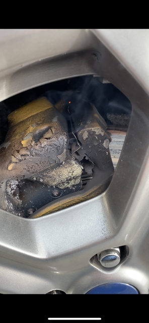

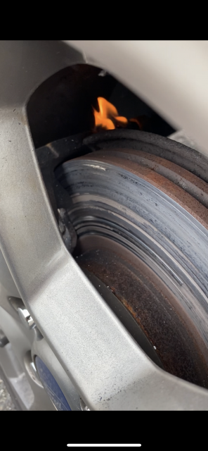

Last Thursday, I took my FiST out for another track day at Lime Rock Park. I have done 2 prior track events and minimal street driving, approximately 3k miles total on the brake setup. Pads were about 60% at the start of the day. About 10 minutes into the second 20-minute session, I noticed severe brake fade, vibration under braking, and smoke. I felt uncomfortable continuing to push the car and decided to bring it back to the paddock.

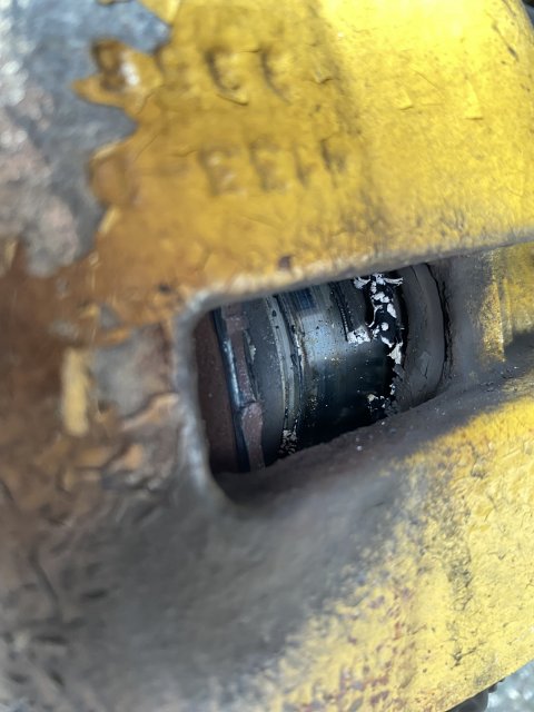

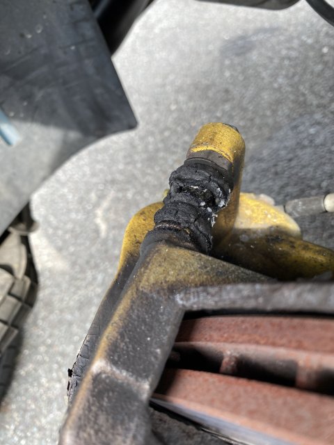

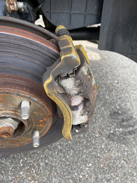

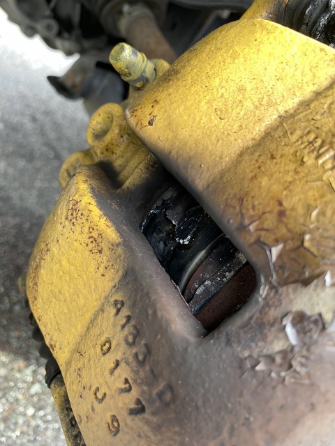

I parked and found both slide pin boots on fire, piston seals completely melted on both sides, brake pads completely gone, front and rear, and caliper paint destroyed (disregard the bad paint job, car came like that).
I realize the torque vectoring eats brakes but do you guys think this is a compound issue or over-driving the car for the current brake setup? Pads overheated and melted the resin? There was tons of debris on the barrels of the front wheels.
I have see others running Power Stop Track day pads with success but I personally have never worn front and rear rotors down to nothing, at the same time. Rears usually last much longer.

I'm wondering if all the pins seized and never fully backed the pads off the rotors. This is wild. Glad you were safe. Is the rest of your car stock? I'd believe if you were 350+hp, full suspension, etc that you could put that much abuse into the brakes. Suggest a full rebuild of the calipers with plenty of lubrication.

I thought similarly but the calipers/pins were thoroughly cleaned and lubed when I put the pads on. Unless the lube wasn't up to the heat range it was exposed to. Everything came apart easily when I swapped pads to get home.
Car isn't stock which might explain it. S280, +30 injectors, e30, falken 615’s, and swift springs.

It's possible the lube itself caught fire, that would explain what you found. I brought my S280 car to lime rock as well but I was on a big brake kit.

I see no ducting at all in your photos.
Novice, Intermediate or Advanced? Sport mode should be all the way off. It wont help anyone over Novice and just boils the brakes with any type of 200tw tire underneath it.

You are correct, no ducting yet. Looking to do the GT3 ducts and pull the backing plates. (much cheaper than boomba with similar results).
Intermediate, haven’t played with the T/C completely off but will do that moving forward. I have a quaife LSD I will be installing before the next event in the hopes to mitigate the electronic assist (even with the T/C completely off).
