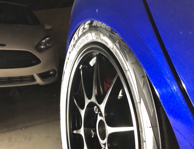

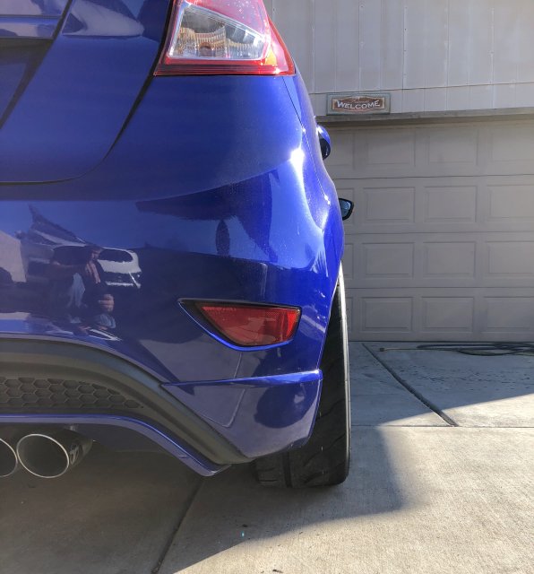

I have R888R 225/45R16 tires on 16X8 ET35 Dekagrams. The sidewalls are fairly stiff, and the tire's aren't overly wide, about 8" tread width and 8.75" overall width mounted on these wheels... the wheels are very close to this width overall width but do not touch when set on the ground flat. Let me ramble on to give you a little more information.
I have had these on both of my cars, one with stock suspension and the other with MeisterR GT-1 and rear camber shims. In summary they fit both ways with a little work and here's the "rub"...
Stock ride height stock suspension it's about 10 mm on the inside between front tires/wheels and struts... had little bit less with the MeisterR because I loaded the OEM bolts to max neg camber. I can take a bic pen and move it between the strut and the tires/wheels with some additional clearance.
Rear it's not a factor on the inboard side with this setup, but the rear fender lip area is of course... if you remove the springs and jack up the axle beam, it starts to rub the fenders as soon as it starts to tuck under. Gentle rolling is probably enough with reasonable ride height as cornering load provides more fender space (rear axle bushing deflection plus tire deflection plus wheel camber change)... regular bumps could cause rubs though.
Ride height --- eventually most tires will rub something sooner or later. Stock ride height means when cornering hard, tires will deflect slightly away from the fenders wen compressed, and the fronts have a little bit of camber gain to help out. On the stock suspension, they look great, and generally no rubbing... but if you hit a big bump or during hard cornering, there may be a touch.
Lower than stock ride height requires more negative camber. In the front, this needs to be done with camber plates not crash bolts as the offset strut bolts will move the tires closer to the struts, and cornering deflection may cause rubbing if it's too close. You can adjust the play in the OEM bolts to easily avoid any rub on the inside. Then max out the play in the top to get a little bit of negative camber.
I would estimate 30-37 ET could work in the front, and 35-45 ET in the rear for custom wheels... the rear fender needs to be rolled to totally avoid rub/contact at stock ride height especially if you add a couple of fat guys in the back seat. With lowered about an inch, rear you need some negative camber and trimming of the liner... EDIT- first picture is the rear jacked up without springs to determine how the wheel/tire fits, way up into the wheel well on both sides... second is on the ground with a fairly low ride height (not as low as it looks) and -2.7 camber and rolled
