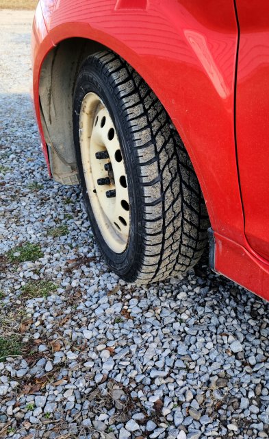

Goodyear ultragrip winter 195/55/15 now. It's done it some with others. These work great so far besides some noise and this issue which is probably more the car and road more than the tires. I'm surprised nobody else has witnessed the car pulling around some. Enough to mention it. If anyone else made a post I'd like to know. Wasn't sure how to describe it.
Maybe I could try tire pressures to see if it helps. Sam4 the light doesn't come on for me till nearly 10psi down. 20211204_112704_resized.jpg
Maybe I could try tire pressures to see if it helps. Sam4 the light doesn't come on for me till nearly 10psi down. View attachment 45845
less 10 is correct for the light, I'm actually referring to minor changes being noticeable - a few pounds. God Forbid you have them rotated and don't make a scene about updating the pressures!
