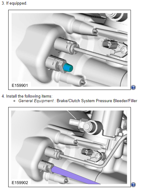

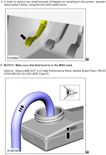

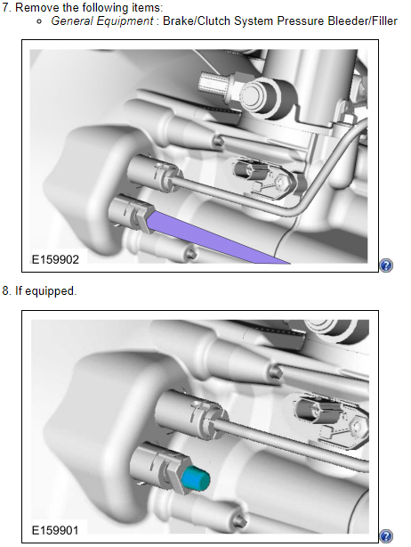

Consider changing your bleeding method and see if that helps. I used a Motive pressure bleeder, and it seemed to work well. I made sure pedal was in the up position while bleeding, and I never bothered with pumping it ….. just pushed fluid through until I saw no more air.

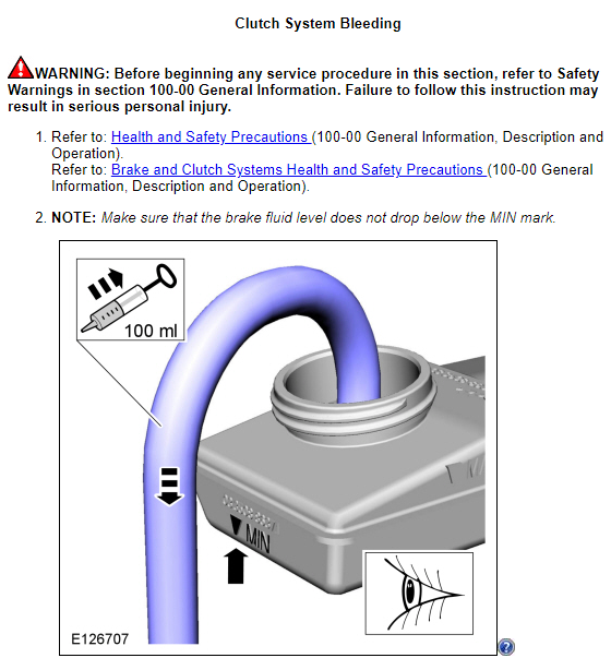

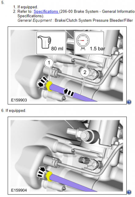

The Motive bleeder pushes from the top …. Once attached to the reservoir, you pump to about 10 lbs. Then, when you open the bleeder, it pushes fluid and air out. I made sure the pedal was up and did the above …. putting about one bottle of fluid through, which was likely more than I had to.
Okay thanks . What did you attach the bleeder to on the reservoir ?

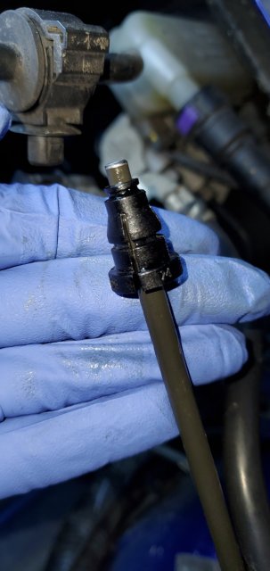

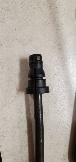

There is a thread on a similar situation on this...The line that goes from the Master cyl to the slave has a little seal on the end that goes into the Slave Cyl. Sometimes this seal stays in the old Slave or gets lost into the abyss of the engine bay or floor without even knowing. I bought like 3 of these lines for like $13 per line just to have spares a while back and used one when i installed my Clarke Built trans as my seal disappeared. CHECK the end of that line that goes into the slave. ill post pics of what you need to see also.
