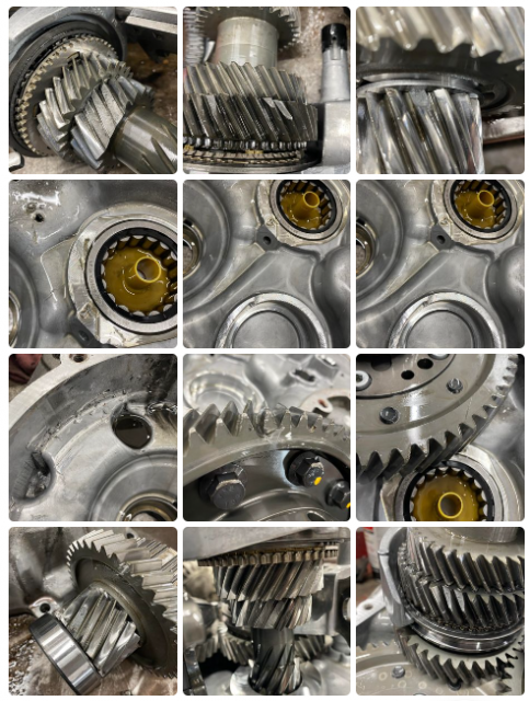

here is what the transmission looked like. Second gear sheared a bunch of teeth, and the teeth flat out destroyed the rest of the transmission.
Car is currently awaiting one radiator hose that needed replacing (on back order). Other than that, it's ready to get put back together.

Was it like a rotational noise when coming to a stop in neutral??

I'll bet a happy meal the Turbo seals are going out with the Smoking upon startup*
