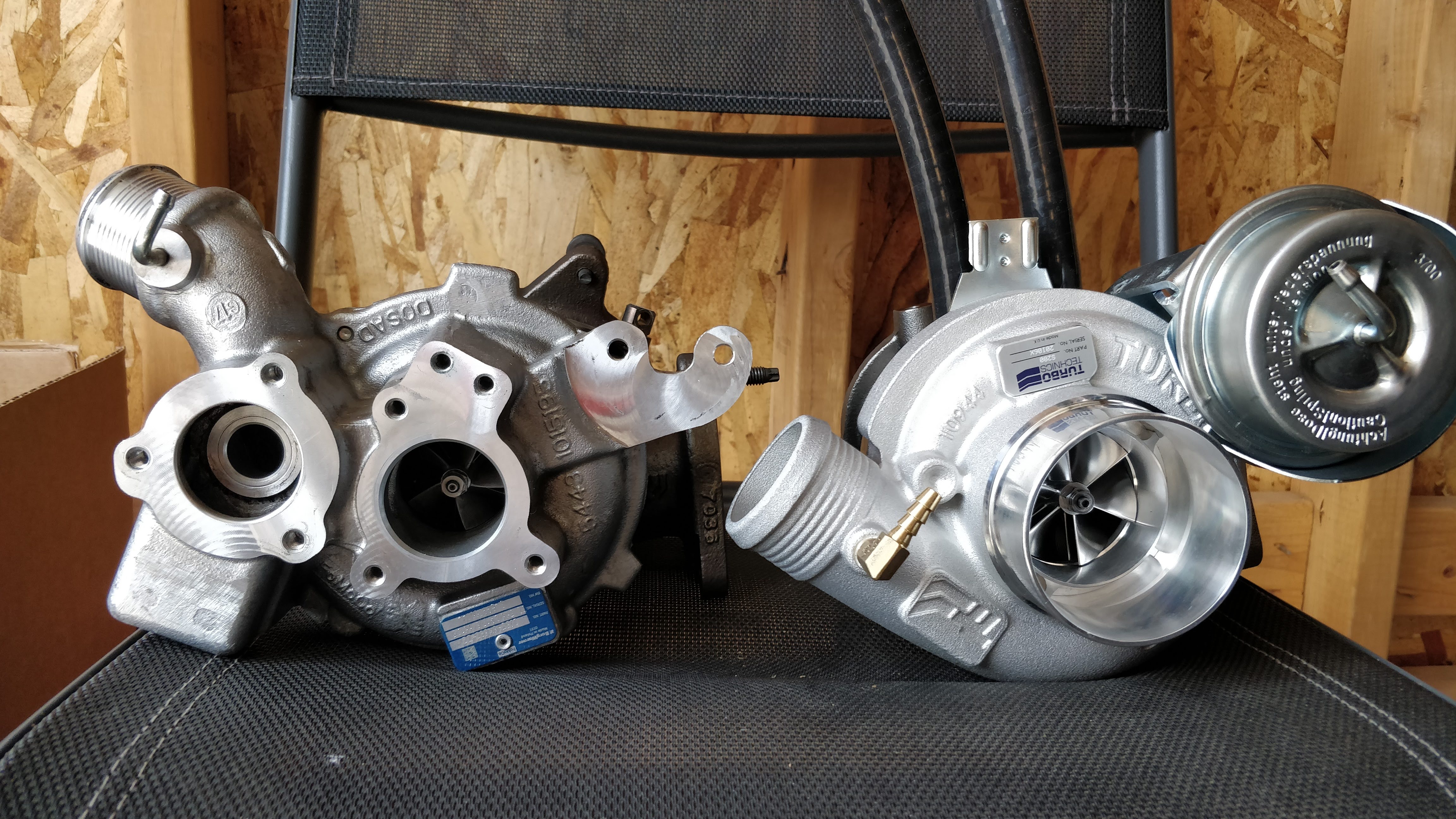

The s280 is a very nice turbo. Install was done by me in my garage in about a day's worth of time spent working on the car. Clearance to the block was surprisingly easy and everything else fit nicely. Side by side, the S280 looks pretty big compared to the factory turbo - I'm sure there's plenty of side-by-side pics in the forums but here's my own.

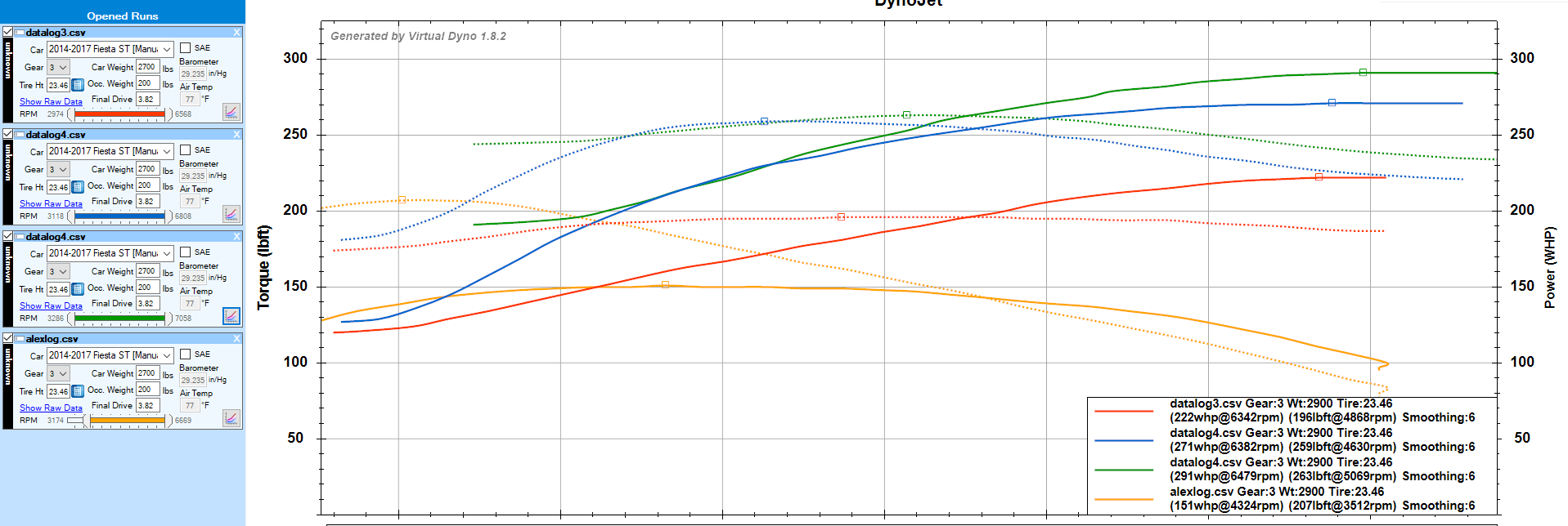

I do all of my logs on the same road, so I figured it was worthwhile plotting some logs with V-dyno to track gains through the tuning process.
Yellow line shows factory turbo, e30 tune with an st200 intake, crossover pipe and intercooler. Probably not the best log I have, but it gets the point across. Highest vdyno readout there was about 180whp, nothing to brag about, but to be expected at 5000+ft elevation.
Red, blue and green show the 14psi base map, 2nd revision and 5th revision for the tune, all 91 octane. Overall very happy with the gains over the stock turbo

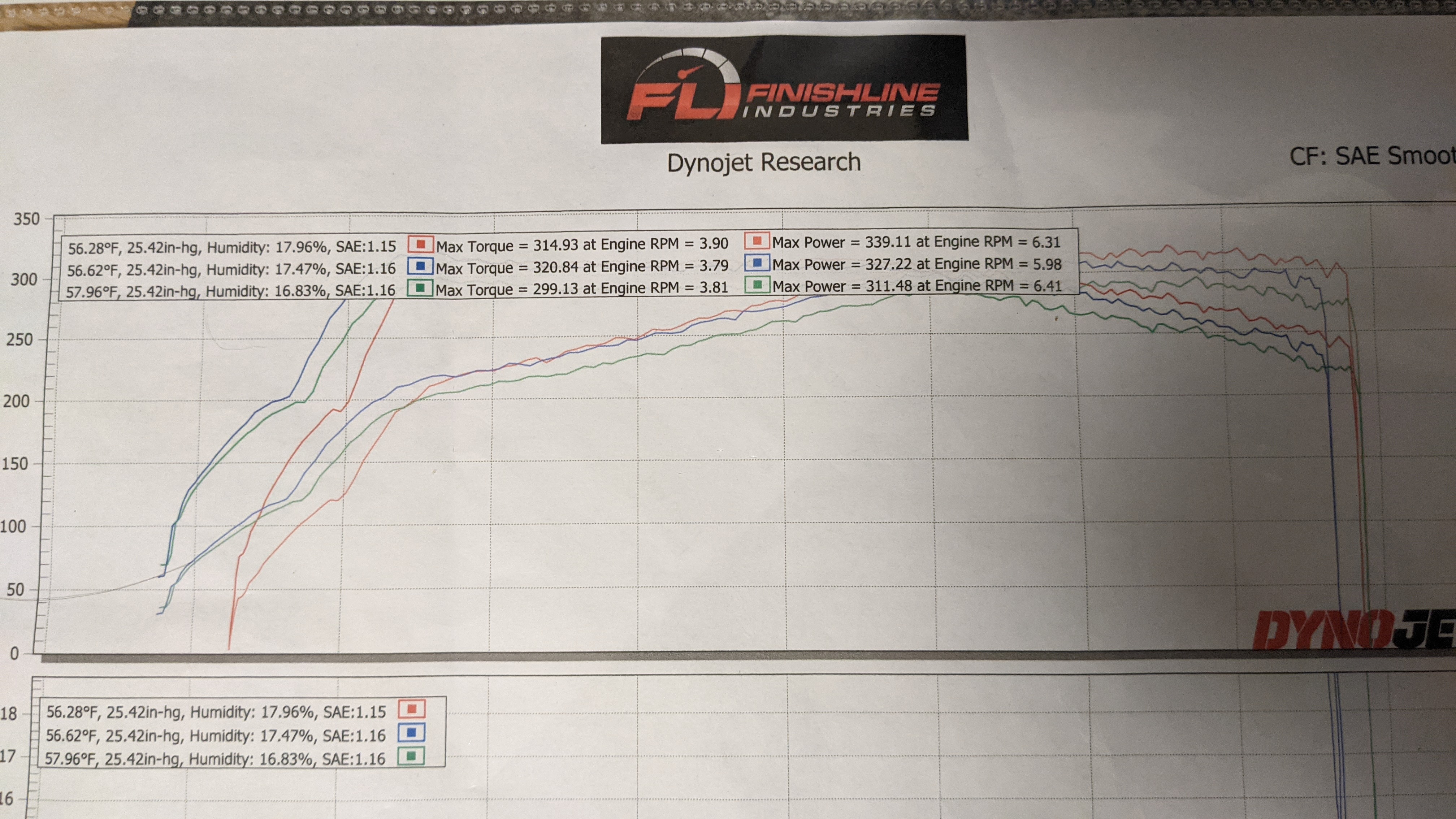

First weekend of December 2020 a local dyno opened up with ~15 slots for a dyno day. I was able to get on the list. The timing was great since Jason had sent the last revision for the 91 tune about a week prior.
Below is the dyno results for the day with the mod list from before
The shop was definitely a little generous with the correction factor, as you can probably tell from the numbers. 339WHP on a factory fuel system on 91 octane, lol, as if. This tends to happen around here a lot in my opinion. Likely causes are dyno days getting overcorrected to make people excited and the dynos being setup to correct too much for the elevation. If I had to guess, I would say they overcorrected by 15%, which would put my highest number ~280whp, which is more reasonable given fuel quality and factory fuel system. I didn't say much at the dyno event since I was the only person that met or exceeded their power goals and I didn't want to make things worse by questioning how much the shop wanted to correct. A friend's bolt-on e30 FiST put down 214whp, which would make some sense at sea level and about lines up with the 180-190whp I told him he would probably put down given the elevation. So maybe the correction wasn't as bad as I think - who knows, all I know is the car drives very well and makes a healthy amount of power now, very happy with the setup for now

I can honestly say that your 280 estimate is more realistic more like 275HP Jason at Dizzy pulled 275-280 tops on 91 I believe. You really cannot get beyond on that on 91 with E30 you could pick up another 12hp probably but honestly you will start having fuel issues as the turbo will flow more air that the stock fuel system can handle. Hence either going bigger injectors and a Hpfp or aux fuel either single or 4 port. The latter issue being the aux fuel is a system from the 90’s that piggybacks of the stock ECU and is not really integrated tuning wise. The HpFp with injection is probably the wiser way to go but its relatively new on the scene so there is not a lot of research behind the duty cycle of the injectors.
Because of all this I tuned for 91 with mine and honestly I am pretty happy with how fast the car is. I am most likely at 275 HP on a dynojet as I was tuned on a recently calibrated Mustang and my numbers were nothing to write home about lol. Mind you the tuner informed me the Dynojet would add 50-60hp to the bottom line .
