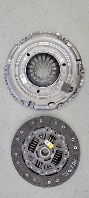

For fucks sake- has anyone had issues installing the st200 clutch? Shop is saying it is sprung and it shouldnt be….wtf

Did you get it from ron? I know someone who order a st200 clutch and it was sprung and much bigger than the fiesta clutch size.
Yee i sure did. After some phone calls we figured out its a focus st clutch….with the exact same part numbers box and clutch. Somewhat annoying but its been remedied afaik, new clutch on the way tomorrow.

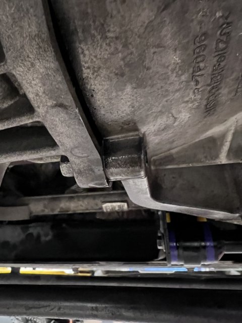

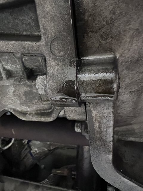

Clutch and diff are in. Feels awesome. Question though for those who have done this: does anybody have a small leak afterwards? Mine is, but the shop says it might be brake fluid. I dont understand why brake fluid would be leaking from where the tranny mounts to engine….
