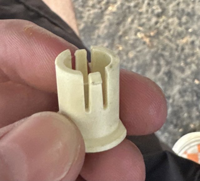

this shot out from underneath the dash earlier
