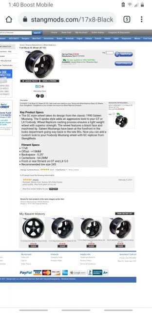

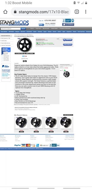

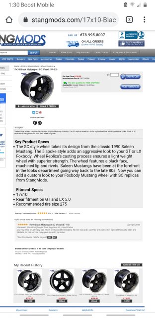

Hello all,
Im trying to wide body my fiesta, but on a budget.
Ive come across cobra rims with the same bolt patten and low offset. Im really interested as to what wheels will fit. Im still trying to understand what back spacing is, and how low or high of back spacing will fit the 2016 fiesta ST's
Ive put some screen shots of rims that i was looking at, will any of them fit??
Thanks 🏎🏎

Offset and backspacing refer to the same thing, but measured from a different place. Offset is the distance from the center of the wheel to the plane of the mounting surface, measured in millimeters. If the number is positive, the mounting plane is closer to the outside (pretty side) of the wheel. If the number is negative, it's closer to the backside.
Backspacing is the older way of measuring this and has largely been abandoned. In backspacing, the distance from the inside wheel rim to the mounting surface is measured, usually in inches.
The wheel you are looking at has a 25mm positive offset, which is an inch. The backspacing for that should be 6". The fact that it's 6.48" comes from the fact that they have a little bit of flange thickness to the rim they don't include in the 10" width designation.
In comparison, the stock FiST wheel has a width of 7" and offset of 47.5 mm. 47.5 mm is 1.87". So the backspacing is 3.5" + 1.87" = 5.37", plus a little for the thickness of the rim. So this wheel will go one inch farther towards the shocks at the rim, and three inches farther out. Therefore the tire mounted on it will bulge another half inch or more than that each way. So the issues you will encounter will be rubbing against the shock or inner fender liner, depending on how much extra room there is to begin with. I believe people encounter rubbing with 225's, and the recommended tire for the wheel is a 275. You will also encounter rubbing with the fender lip itself, as the wheel will definitely not fit under the fender. In addition, although a 275/30R17 would have the exact same diameter as the stock tire, there is no tire made that size. Going up to a 275/35R17 is possible, but you will find only Hoosier drag radials and an all season P Zero made for Porsche in that size. All are priced very high and are also 1.1" taller than the stock tire. There are lots of reasonably priced tires at 275/40R17 but they are 2" taller than the stock tire.

I just noticed the middle wheel is a 17x8. Its backspacing is similar to the stock wheel. A 245 is the recommended width on that, and a 245/35R17 is available in the Toyo Proxes R1R. Almost stock diameter (about a quarter inch taller). Oddly, if you try going down in section width, to 235 and 225, nothing is really available until you get to 225/40R17, in which case you're an inch and a half taller than stock.
