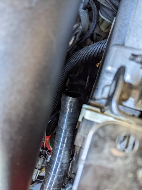

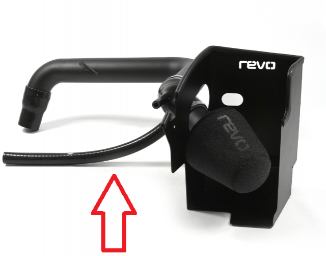

Hello guys, I hope you are all doing well...
I have found and fixed 50% of the problem.
Turns out, this hose was completely disconnected.
The car now has a normal cold start.

What actually was the hose that came loose? I’ve a similar issue with regards to noise in cold starts.
