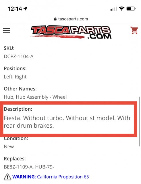

That part number is for a non ST fiesta. Not for our cars.

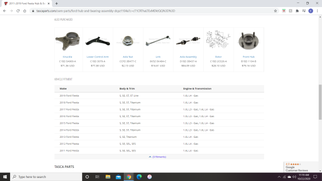

+1, DCPZ-1104-A is what you want... See below:
https://www.ebay.com/itm/Genuine-Ford-Hub-Bearing-Assembly-DCPZ-1104-A/193705097794?epid=1311117834&hash=item2d19b93a42:g:dEEAAOSwgxpfgnY3&fits=Year:2016|Model:Fiesta|Submodel:ST|Engine+-+Liter_Display:1.6L|Make:Ford|Trim:ST+Hatchback+4-Door|Engine:1.6L+1596CC+97Cu.+In.+l4+GAS+DOHC+Turbocharged
jeffreylyon
1,320
1,115
Pittsburgh
You sure? The pictures included in that listing show a drum brake application and the hub looks like it's got holes to access the adjusters. The ST hubs have no additional holes, which is important for us 4x100 folks.

Confirmed at dealership. Ford does not sell a full assembly. You have to buy all $300+ worth of parts and build it yourself.
Junk yard it is...
