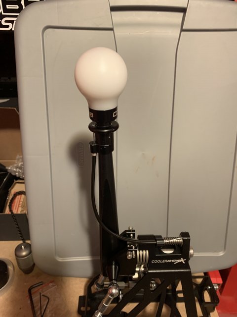

The machined components that make up the unit are very impressive and the design is borderline incredible. I really appreciate the amount of time and thought that went into designing the system. There were two imperfections on the unit that looked like either a burr on a machined piece and/or an imperfection in the paint. I quickly forgot about these once the unit was in the car because they could not be seen and the performance of the shifter overshadows everything else about it.

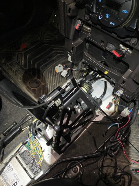

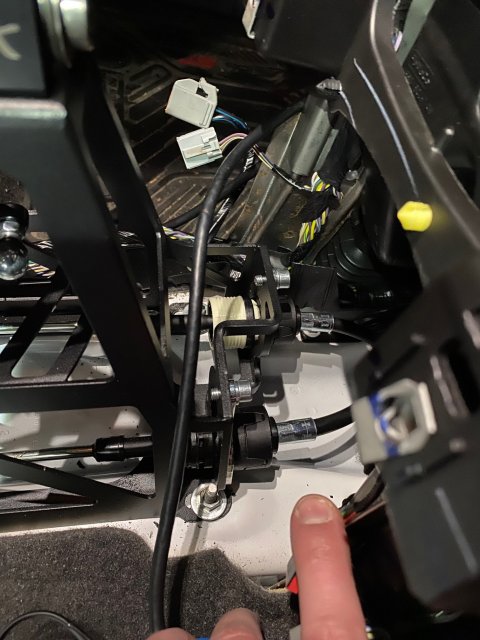

  • Once you remove the center console and surrounding plastics, you will be ready to remove the shifter assembly.

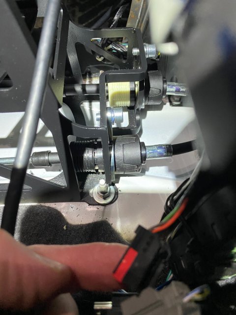

  • Take a second to note that the shifter cables are plastic and relatively delicate. Get familiar with how they lock into their respective locations with the locking collar; Understand the mechanics before attempting to remove
    • Use plastic trim removal tools for this job to limit the possibility of damage
    • Once cables are removed from the OEM shifter assembly, unbolt the nuts holding it to the vehicle chassis while taking great care to not drop the nuts into the various small holes in the vehicle body
  • Upon getting ready to drop in the Coolerworx shifter, install the shift cable collars first
    • I recommend you do not bolt down the Coolerworx shifter before getting the cables in the locking collars on the shifter first
    • You will need to bend your shifter cables to get the shifter to bolt down to the OEM studs on the chassis and doing this after the shifter is bolted down is virtually impossible
    • I suspect that the UK Fiesta shifter cables are different in either how substantial they are or the routing or the length because I could not install them how Steve did it in his video (I spent about 2 hours trying to do it the way he recommended)
  • After installation, ensure that all jam nuts on the adjustable linkages are tight. Coolerworx adjusts these at the factory so that no adjustment is necessary for the shifter install but after my first drive, some of the jam nuts loosened up.

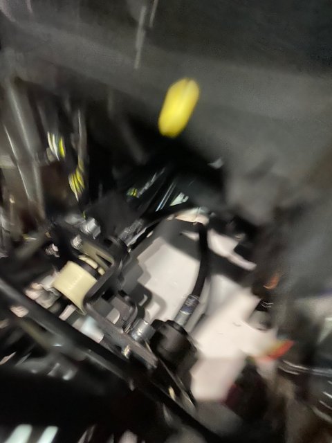

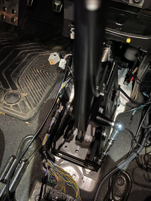

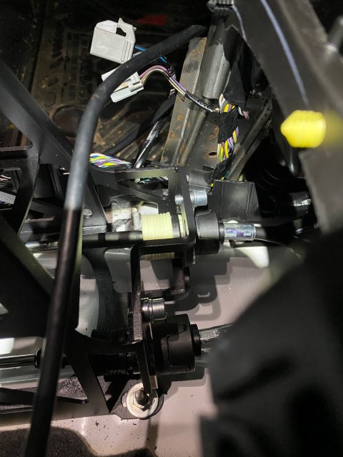

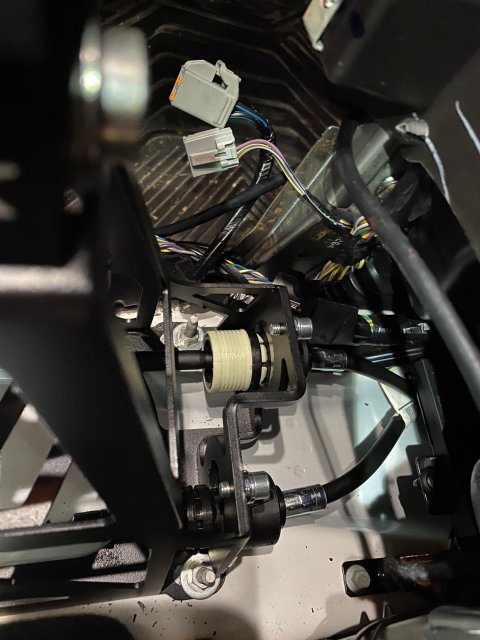

Unfortunately, I did not take as many photos as I originally planned because of all the cursing and bleeding that transpired while trying to get the cables seated in their respective places. Once I realized that I could install the cables before getting the Coolerworx shifter bolted down to the OEM chassis studs, the process took about 30 minutes.

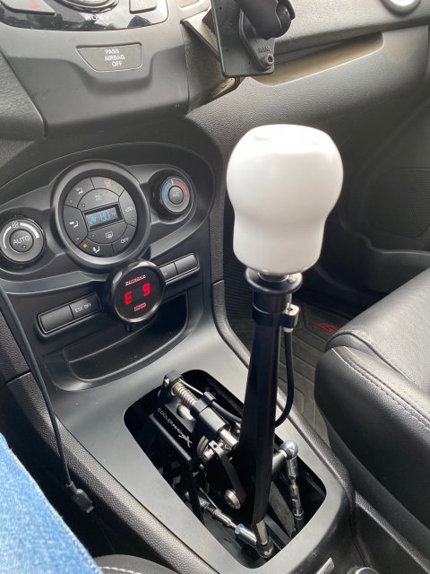

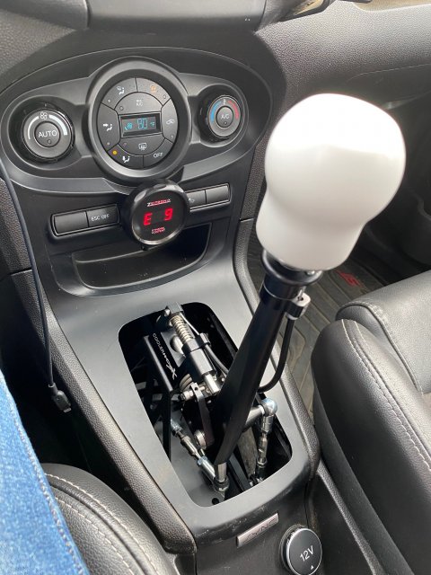

Once those two steps were completed, though, the remainder of the install is just putting the plastic trim panels and center console back in place. I left my shift boot off to expose the mechanics of the shifter. It is truly impressive what they were able to design and build and I want to keep it exposed so I can stare at it at red lights. I did not need to trim any of the plastic trim panels.
Adjustment of the grub screws is straight forward and you can see in the attached video where each one is supposed to go. In the video, I also shift into each gear while at a standstill and demonstrate the shifter play in each gear:

Love mine. I put the cables in before bolting it down and literally had to put my entire body weight into getting it over the studs.
Exactly this, not fun. I felt so bad for my shifter cables but so far so good, no binding of any kind.

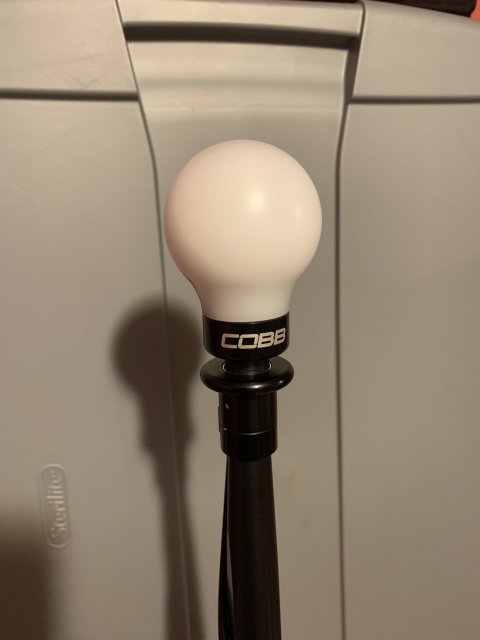

My Coolerworx finally arrived yesterday! I knew I wanted to use my cobb knob for a subaru sti, it's slightly smaller than the fiesta cobb knob, fits my hand better. While I was waiting for the Coolerworx to get here, I ordered a 12x1.5 threaded insert and drilled and tapped the knob. Fits perfect and looks great. Can't wait to see how it feels now.
