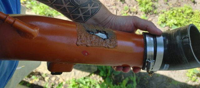

I’ve had my CPE intake on my 2016 for about 6 months. I just took it off to sell it, but I noticed that spots on the intake piping have been resting on the engine, metal to metal, and now there are two pretty deep gashes in the intake piping.
Has anyone else had this problem?

Those are the two gashes. They’re like a centimeter deep maybe. Probably half way through the piping wall.
I’m not really sure if I could have prevented it. The intake only goes on like one way.

the tube pictured has a silicone coupler at both ends which does allow for adjustment. So you are correct it goes on one way but does allow adjustment opportunity
I'd be curious if anyone else has pics of their intake installed without the tube hitting anything

I had the same problem with the CP-E tube hitting as the photo Based posted and the the rubbing into the hard AC line as V_2. It wasn't worth the compromises in the long term, so out it went. Whatever adjusts can be made weren't good enough for me especially with the motor moving around during spirited drives.
here's a photo of the AC line behind the silicon elbow in the photo below the CP-E pipe was digging into, which has been covered with a split fuel hose that I ended up just leaving there. Note that I have ample clearance now with the RAMAIR crossover pipe and 3" elbow to the turbo [burnout]

Mine rubbed through the heat wrap and left a small gash along the straight area of the pipe, similar to the gash above OPs thumb in his picture. I saw it was bottoming out during the install and made every last effort to go back and readjust to get as much clearance I could get in this area, and where the pipe makes a 90 degree turn toward the turbo. The best I could do was 4mm which apparently is not enough. I have 40k miles on the intake. I don't think there's any adjustment left in the silicone coupler.
I cant see underneath the pipe to confirm if I have the second gash as shown in OPs picture.
No issue with the AC line on my car.
See pics for reference.
