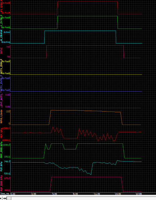

When trying to start, it cranks fine but occasionally hitches and stops. The only indication I can tell going through Forscan is the cam position sensors sending a fault signal. But, I have replaced the cam position and crank position sensors as well as the vct actuators without any benefit. It did initially only read fault on the intake sensor, but after replacement, it reads fault on both.

- Cam position sensors(CMP1_INK_F, CMP1_EXH_F) bolt read fault during start
- SYNC does read YES in Forscan

Here is the Forscan log from the last starting attempt.
