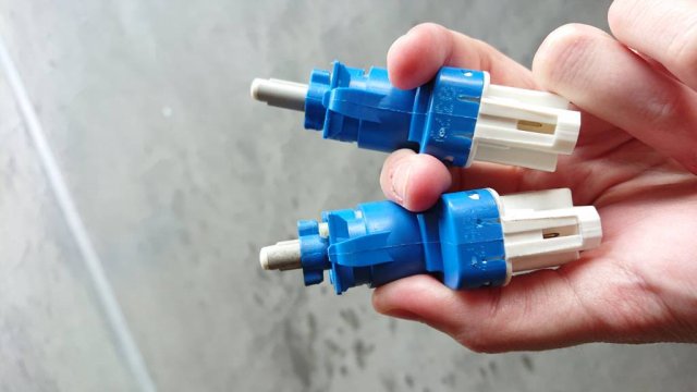

I have had to replace my cruise control switch (the blue one on the brake pedal under the dash) twice since the start of the year, and it's still August. It was also supposed to have been replaced a year ago, too.
I have swapped this switch because it appears to give me brake problems. The first and third switch replacement was to solve dragging brakes. The second switch replacement this March fixed vague brakes (see this thread about that whole saga).
I don't know how I keep killing these switches. I bled my brakes often; I have spent about 10 weekends a year at racetracks doing laps for the last 3 years and I only upgraded to bigger brakes in July. If I need to add one of these switches to my usual brake service parts that's okay, a new switch from Rock Auto is $5 plus shipping. But I would rather figure out how to fix the underlying issue it at least why these switches die on me.
Had anyone else replaced their cruise control switch more than once? If I only had to do this once I wouldn't be as concerned, but this is a ridiculous service interval for a brake switch.
Attached is a picture of the switch I pulled out from under my dash (left/bottom) and a fresh one (right/top). DSC_0180.jpg

Im wondering if repeat hard stops are crushing the internal plunger. If you bury your foot in the brakes ( enough to deform the pedal box like whats happened to you already. I could see this part failing probably just before youre bending stuff.
EDIT: i looked at how the switch engages/ disengages. From what i gathered there is an internal spring that is probably getting bent or busted when you let the brake pedal slap the plunger really hard letting off the brakes.

Maybe. When I get a chance I'll disassemble the old switch in the first photo (the one that isn't extending fully) and see what I can see. I don't side-step the pedal and I'm already trying to be smooth off the brakes, but I wonder if I'm overextending the switch. These issues seem to start if I go *deep* into the pedal, which is mostly when the brakes are being bled, but sometimes when I go off track and I'm "two feet in" trying to get control back in the grass and dirt.
