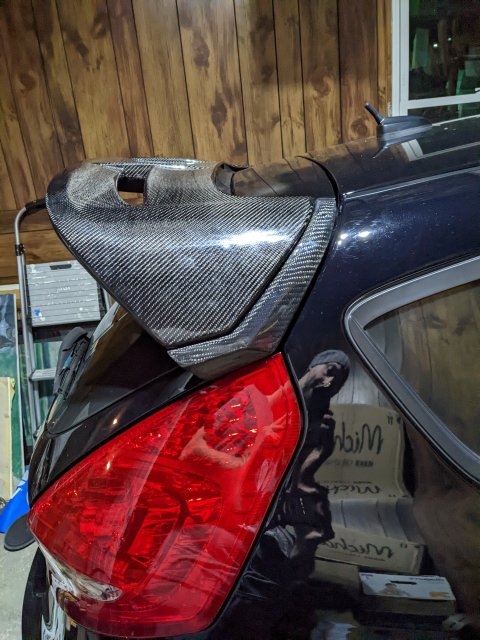

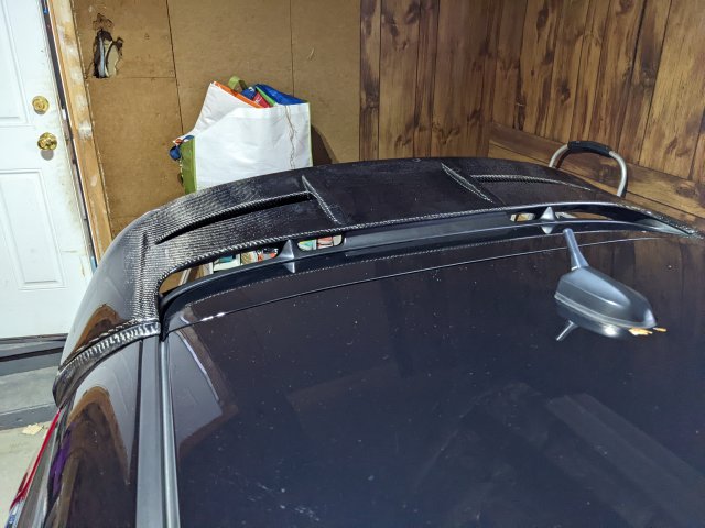

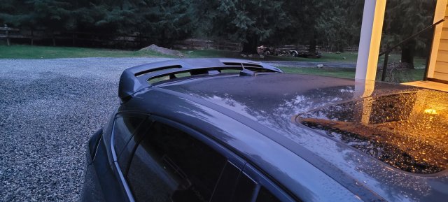

It went okay, I had to apply a lot of pressure to the middle also to the point where it was making cracking sounds to get it to line up with the center bolts. I also had a wonderful time of trying to figure out all the hardware, because the carbon OEM wing had different mounting bolts to it. But all in all both look good together. Glad I didn't pay full price for them, I probably wouldn't be staying up at night thinking about it lol. PXL_20220301_035506354.MP.jpg PXL_20220301_132357566.MP.jpg PXL_20220301_034852710.MP.jpg

It went okay, I had to apply a lot of pressure to the middle also to the point where it was making cracking sounds to get it to line up with the center bolts. I also had a wonderful time of trying to figure out all the hardware, because the carbon OEM wing had different mounting bolts to it. But all in all both look good together. Glad I didn't pay full price for them, I probably wouldn't be staying up at night thinking about it lol. View attachment 47257 View attachment 47258 View attachment 47259
That looks so good (y)
