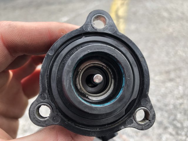

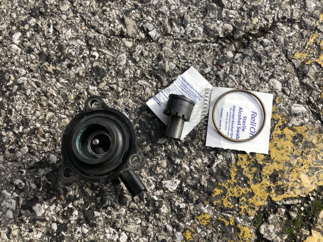

first off, 2014 model and the only engine mods are the symposer delete and a 2jr intake. no tuning, stock everything else. was driving last night normally and lifted off the throttle in 3rd gear and got a very loud whoop-whoop-whoop from the turbo. pretty positive this was surge as the check engine light and wrench illuminated immediately, went into limp mode and shut down. after doing lots of research i suspected the diverter valve but after looking at it i dont see anything wrong.
first question, does the disassemble any further?
second, if the valve is fine (which i will upgrade eventually anyway) what is my next step?
i haven’t pulled codes yet so that will be coming shortly

Does the piston in the Diverter valve still move up and down freely when you push on it? I am thinking failed valve but that shouldn’t cause limp mode immediately as you describe.

there seems to be some resistance but its not locked up. regardless its getting replaced and i have the battery disconnected until the bov is installed. codes will be pulled prior to next start up as well
