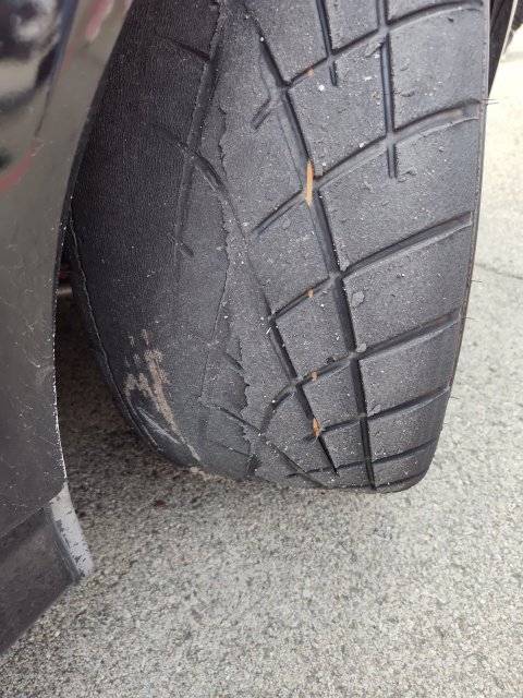

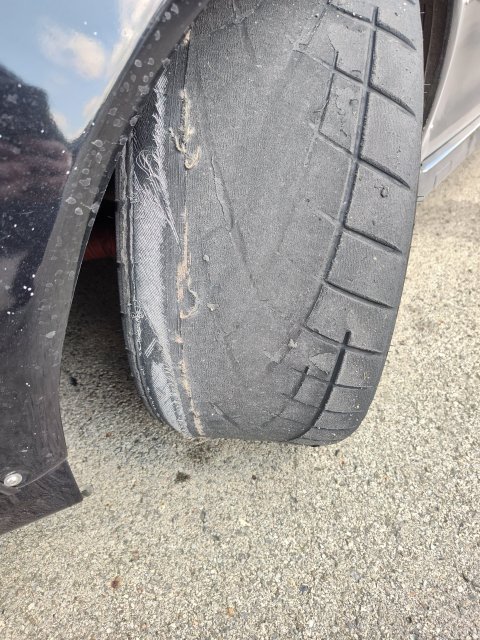

So here's the rundown.
Toyo Proxes R1R 245/25/r17 on 17x9 wheels, 1/16th toe out, -2.5 deg camber. Tires mounted last July, about 5K miles with about 12 track sessions last year, 2 this year at Watkins Glen, and another two full sessions this past week at PittRace. Tires brought inside for the winter.
Cold pressure usually around 36psi. hot 44 and 42 front and rear respectively (been told that's probably a little high, so it may have contributed).
Was running at the Glen at the end of March, tires were great, but blew my clutch early in the day, so I only got a few sessions.
Cut to this week down at PittRace, felt like I was ice skating, tried lower pressure, higher pressure to no avail.
Tires had 4-5/32nds tread before heading down to PittRace.
A few laps into my 3rd session I'm hearing a swishing sound and feel a synchronous vibration in the wheel, so I pit in.
Upon inspection I find total devastation of the front tires (rears were expectedly ok).
So, to all the more experienced track drivers out there, did I overheat them? Overinflate them? Did they heat cycle out? Some combination therein? My alignment isn't crazy aggressive and I verified it again yesterday.
Brand new set of tires mounted, balanced, and installed yesterday.
Thanks in advance.

With the information given, my opinions are:
- I agree tire pressure is too high, I have less power and less tire but I shoot for 28-32f and 35-38r psi. Even when I am tracking my mustang (4k pounds with me in it) I am not getting into the 40+psi range.
- Heat cycles, at 12 heat cycles, the tires have probably lost pace and are not at peak grip, but they should still grip at about 70-80% of what they are capable of. The only way I could see 12 heat cycles playing a role here is if these tires are old and could not hold together after the heat cycles (I've had this happen on 6 year old tires)
- Toe out, while it makes the car turn in and rotate better, accelerated tire wear is the main reason I do not run any toe personally. Most of the people I know running toe on their cars are competing and either don't care about tire wear or are buying tires after they get a certain amount of heat cycles. I personally run zero toe on all my cars and enjoy driving my tires to the cords even if they lose pace.
- Have you run these same alignment settings on a different tire? if you are not chasing a certain time and/or competing. I would switch to zero toe and drop tire pressure as my first adjustments.

Unfortunately I can't try different tires, for the time being with my setup I'm pigeonholed to the proxes, not really any 245/35r17s out there. I'm working on getting a set of 16s for the track to open up my tire options.
Markings on the tire indicate they were made sometime in April 2023, so only a few months before I had them mounted. So I would hope age wasn't a factor.
I just do HPDE so I'm not trying to win anything.
I have more track days coming up in July so I'll reset the toe to 0, and give lower pressure a try.
The 1/16th toe was originally setup at a local shop (owner runs with SCCA I think) so he probably had race car on the brain.
I'm just there to learn and hopefully improve season over season.
Thanks for the advice.

Age of tires definitely should not have been an issue. The toe setting likely was having a fwd racecar in mind. I used to run some toe out on my old integra, it was faster, but I would rather get an extra track day out of my tires.
Shameless plug, but if you want to try the Continental ECF tires, they make them in a 245/40/17. Slightly taller tire but with my discount code in my signature you will get one of the tires for free when you buy a set. :)
