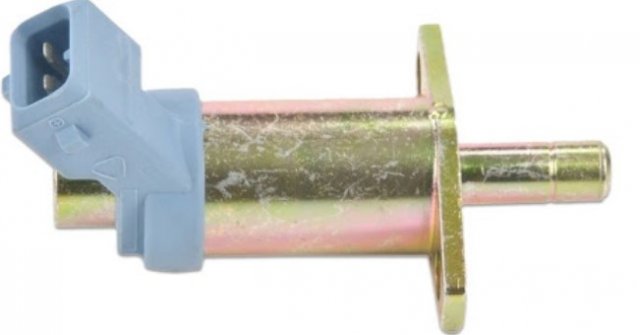

I have the same dilemma @Feisty Fiesta7 ......debating Whoosh hybrid or S280 or.......who knows what else, but also considering the quantum leap in cost to add HPFP and injectors to what amounts to a relatively low bang for the buck (**IMO**) increase in power once the stock fuel system limit is reached on these turbos. A really large turbo on these cars just doesnt suit it IMO.
Im having a hard time not following my previous junkyard solutions approach on this car and finding creative ways to increase fueling without cost/complexity. In my old universe (Turbo DOdges), we used to use these cold start injectors all the time for a crazy cheap way to add fuel. They work beautifully and most guys found they could supply ~30 hp worth of fuel (Saab/Volvo cold starts) or ~15 hp (VW version). Wed trigger them on a simple boost switch (no 3D mapping necessary) and literally 25 bucks later that was it. Some guys would even stage them and have 2 or 3 of them that would come on at different boost pressures. On the FiST, this would obviously be tied into the LP side of the fuel system of course.

Oh nice! Never heard of that before. I think I’ll be going s280 just for the fact I can make the power I want with aux fuel and still have room to move
